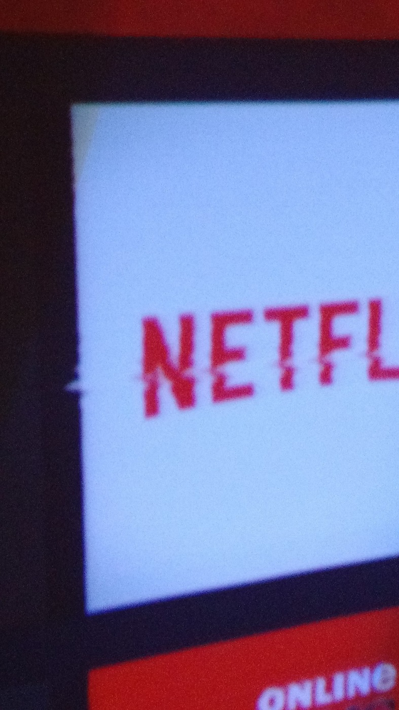

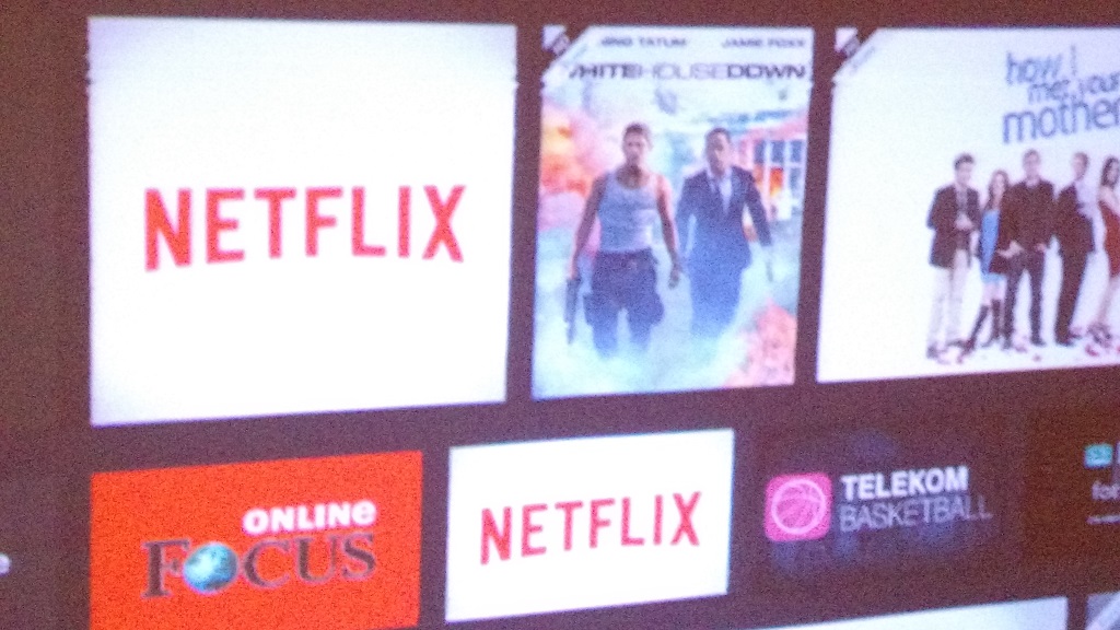

I have suddenly problems with my Marquee 9500. I cant exactly explain the issue, so i decided to take pictures of it. (its on all the three tubes) Its only when im using a HDMI to VGA adapter, like the HD Fury I or another one from amazon. And the problems are from device to device bigger or less. For example on my notebook there is no problem. HDMI and VGA. But all my other devices are making problems -.-.
Why ?? I tried 7-8 different HDMI cables, from short to long, from expensive to cheap.
Do somebody has an idea here ?

Are you referring to the large vertical bands in the image? Is that from a BluRay player? Try another BR machine if possible.
If the projector test patterns look good then you likely have issues with the source hardware.

No, the vertical bands are from the camera. I meant the horizontal issues in the picture. I tried 5 different sources Sad
Yes the patterns looks good.
Only when im using my laptop as a source there are no issues...

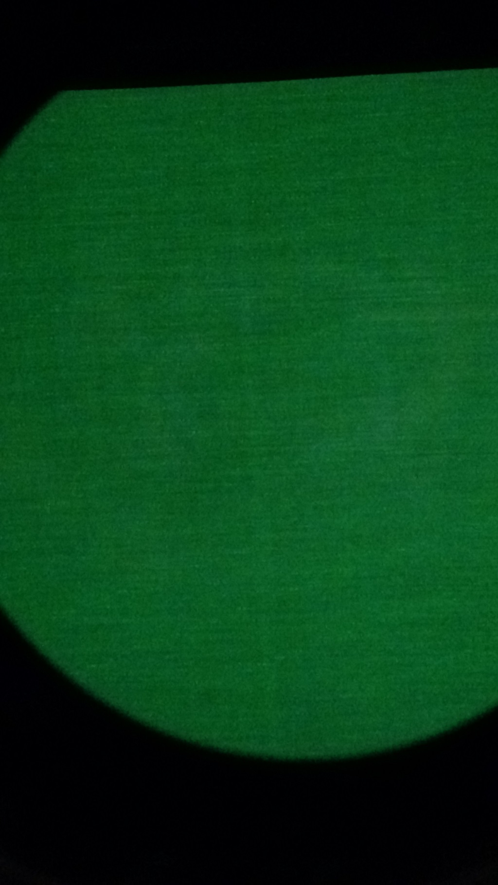

Could we see a full white pattern with the problem visible? Looks like bunching and spreading of scan lines and that can only happen in convergence, suggesting a control board or convergence amp issue.
A full reset of the control board with a fresh setup may be worth trying.

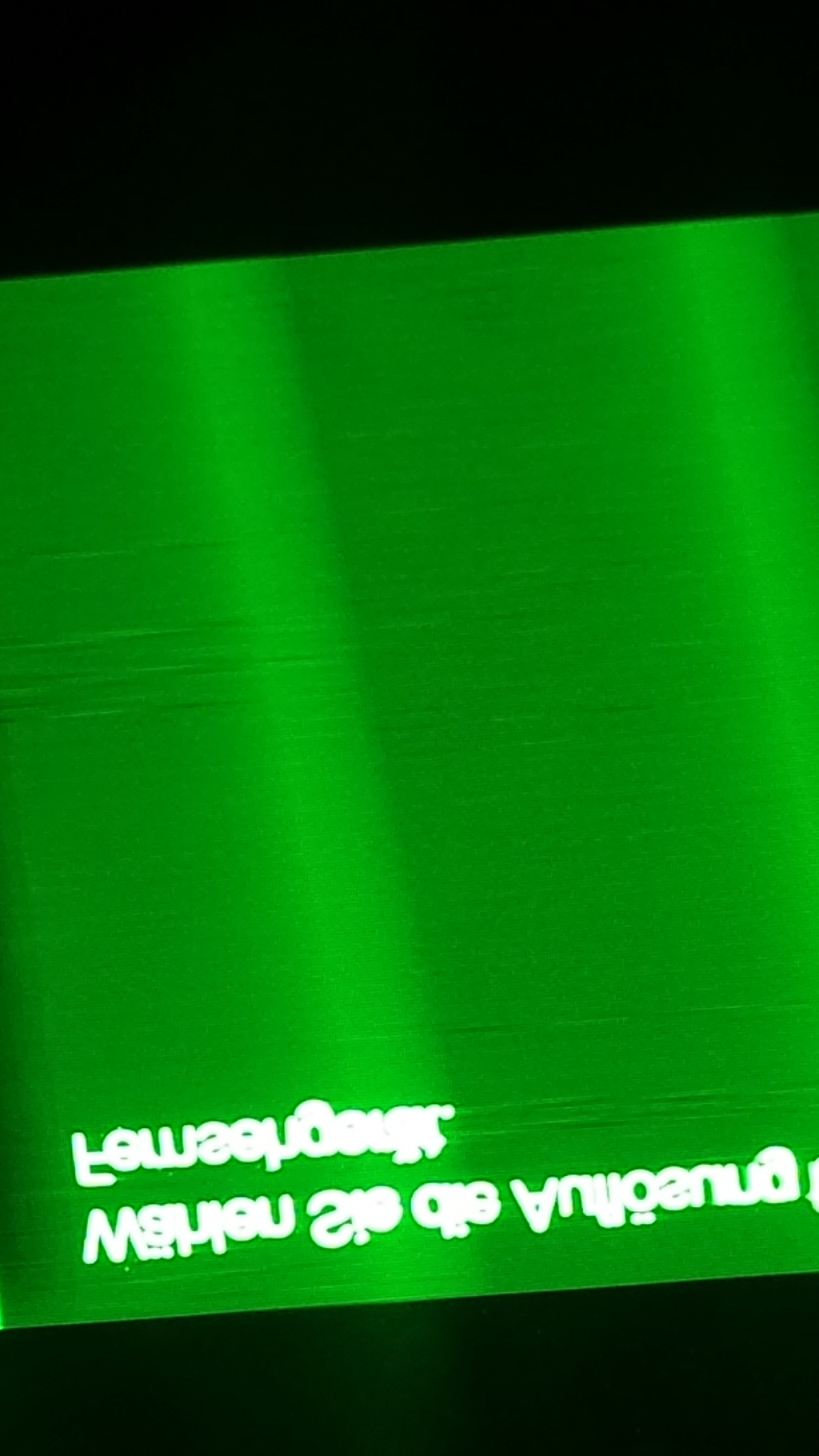

Here are 3 pics. One with the white pattern. I only were able to catch it with the camera on the tube itself.
The horizontal waves are moving over the whole picture.

If the problem moves around the image then your horizontal deflection board or deflection processor boards are suspect. Do you have any spares?
You might try pulling U7 from the DPB and re-seating it in its socket, the pins can tarnish over time.
