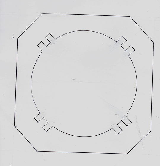

I have been playing with a 808s and I can say it is a great machine. If you get the 808s make up some adaptor plates and fit HD144 or 145 lens. Great upgrade. Curt should have lens. Very easy to setup once you work out the menu. I have had a Sony VPH1272 in the past and the Barco is much better.
There must be a lot of people still using their 8inch AC Barco's as these plates never come up for sale. You don't even here of projectors with the upgrade for sale. Maybe there isn't that many plates out there. Picture of the plates I had made up below. These were water cut out of 6mm alloy. The Scheimpflug adjustment is not affected.

Posted: Wed May 27, 2015 3:41 pm    Post subject:
Ok I think I'm going to buy this machine. Will tell you if there are any news.
Is the PNG a 1:1 capture? If you'll give me the exact (metric prefered) meaures I can make a CAD-Model and get a CNC-machined plate.
