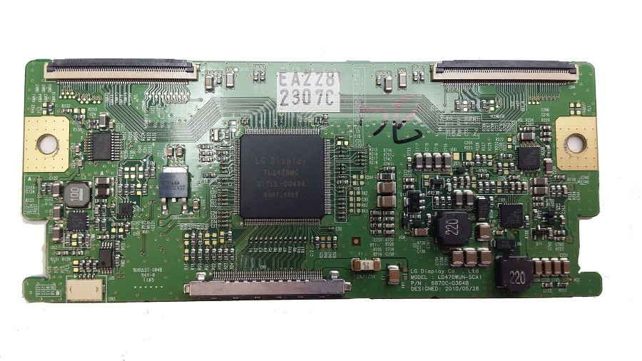

Found the T-CON board on ebay: LG M4715CG CONTROL BOARD 6870C-0364B
http://www.ebay.com/itm/LG-M4715CG-CONTROL-BOARD-6870C-0364B-/171291116225?pt=LH_DefaultDomain_0&hash=item27e1bf02c1

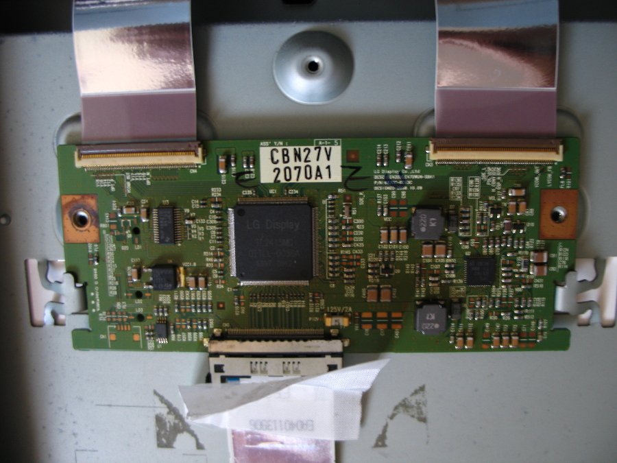

Mine is an older version, slightly different layout. BUT it says from the same model TV. Do you think it will work?

My current board
 Filesize:  287.62 KB
 Viewed:  115 Time(s)
Posted: Wed Apr 29, 2015 9:26 pm    Post subject:
It's possible, but it's common for production runs to change, so all you can do is try it. Did you check the 2 amp SMT fuse on the orignal board? Those can blow open for no reason, giving the exact symptom you describe.
<edit> never mind on the fuse, you did get a pix with Svideo. Not the fuse.
If the small print part numbers match up, you're OK. if not, they won't work.

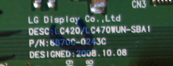

Posted: Wed Apr 29, 2015 9:42 pm    Post subject:
Here they are. Slightly different numbers. The eBay part is newer:

47" Monitor current part number
 Filesize:  86.31 KB
 Viewed:  107 Time(s)
Posted: Wed Apr 29, 2015 10:02 pm    Post subject:
I'll bet they won't work. Made that mistake a few times. You'll probably get a pix, but it may have lines, be pixellated, etc.

Tried the new T-con board, got no picture. I have it open and I'll be cleaning things with Caig's. I may just swap back to the other board to see if I can get it to go.
