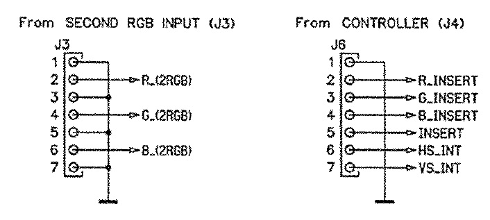

Posted: Tue Apr 21, 2015 7:05 am    Post subject:
I don't think that the wrong connection will have fried the controller. If You compare the connectors, placing the cable into J3 instead of J6 will shorten three lines to GND. This isn't nice, but the buffer IC on the controller (U31, 74AC541) should survive this...

Decibel
Joined: 31 May 2007
Posts: 904
Location: Roma - Italia
Posted: Tue Apr 21, 2015 9:40 am    Post subject:
Bodi79 wrote:
Went through some threads and noticed i made an stupid error.
I connected the cable from the controller to j3 and not j6.
I was wrong many times to insert that connector but the controller was never broken.
The issue is certainly elsewhere.
Domenico (Barco fan!)
Hulio
Joined: 15 Apr 2006
Posts: 494
Location: Belgium
Posted: Tue Apr 21, 2015 10:00 am    Post subject:
I can confirm that too. In the past, i did connect the controller on my former Cine 8 to J3 by mistake but nothing went burned or broken. The projector just went on and off, trying to boot. I remember getting crazy but after realising and using the right jumper, everything went back to normal.
