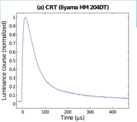

Why you don't see the scanlines at higher refresh is caused by the non-linear nature of the phosphor's luma response (see attachment), with higher refresh the phosphor's output isn't decaying that much. A good related question: is the phosphor burn depending from the refresh rate at a given resolution?
As for the flickering: when I had my NEC 6PG xtra in the begining I used with 720P-72Hz refresh, and whle it was fine I easily could notice the flicker of it, later switched to 1080i-96Hz, and I see zero flickering, only the scanlines can flicker sometimes. Still find that the best compromise even on my XG135, now that my eyes are used to the 96Hz refresh I notice the 72Hz's flicker more extensively. On a 9" machine one should play with interlaced resolutions even further: 1080i-120Hz or even 144Hz, those resolutions should hide the line structure of the interlaced picture...

The phosphor decay is interesting. The theory (or fact...) behind that as a justification for higher refresh must be that even though the beam is moving faster, and imparting less energy per pass, somehow the phosphor is being excited to close to the same level as a lower refresh rate with every pass.... But that would only be true in the case of saturation... Or is it that the same average amount of energy is being imparted to the phosphor over time, just at a more even rate, which brings you up the decay curve, but reduces the peak of the curve? And because of that, the parts of the beam that you normally don't see come into view, like the hazy edges of the beam (which reduce resolving power, I think) because they are being brought up the curve. That's interesting. There's some math there somewhere... I'm going to have to play around tonight... Very Happy I'm still thinking that actually hurts resolving power, though...
On the phosphor as well... if the refresh rate is increased, the perceptible brightness (or brightness perceived by us humans) should decrease, because the instantaneous brightness of each higher speed redraw is diminished. We perceive instantaneous brightness as being brighter than average brightness with the same energy over time. So, if you increase the refresh rate, don't you perceive a drop in brightness? (I'd say yes, from experience) An equivalent would be high intensity LEDs... They are pulsed at a high frequency to emit more instantaneous light but keep the heat down, versus a continuous on with the same average current. Continuous on would be perceived as dim compared to the higher power flashes. There's dark time with the flashes, but we don't perceive it (unless we move our eyes and the flashes spread out...).

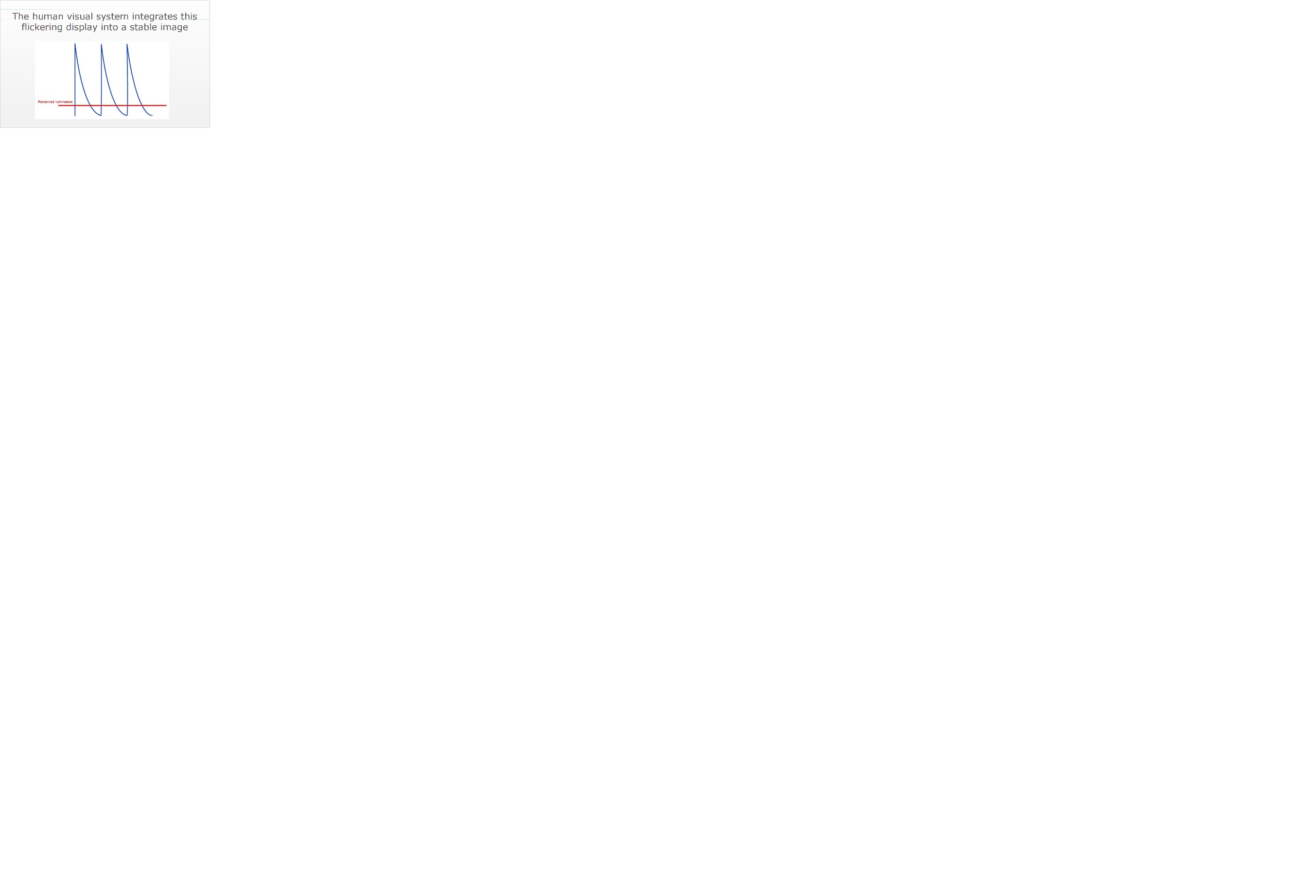

Hey, this seems to be from the same presentation...
If the peaks drop, the perceived luminance will drop as well... You'll gain stability (and reduce flicker), but you'll reduce perceived luminance... Not sure that's good. Again, seems like a personal trade!

Posted: Thu Apr 02, 2015 7:38 pm    Post subject:
- M
Yes, but the phosphor is excited by the current of the electron beam, so the fact the beam moves faster have no effect on the height of the peak, on the other hand if we contentrate on a small (fixed) portion of the phosphor that area gets more excited during the same time period with higher refresh than with a lower refresh, thus its integrate is also should be higher therefore the percieved brightness should be higher with the higher refresh.

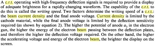

If this were true, then reducing the size of the raster on the phosphor, while leaving all other constraints the same (refresh/resolution, etc.) would not brighten the image (yet it does)... The same is true for oscilloscopes... if you want to see the trace of a high frequency signal, you have to increase the intensity (i.e. accelerate the electrons harder at the phosphor to increase the power imparted, P = I*V). If it was purely the current in the beam, then you would see the trace, no matter how fast it was being swept. Something's wrong there...
There is a time component... current is the amount of charge passing a point over time... (an Ampere is 1 Coulomb of charge passing a point in one second) The intensity of phosphor luminescence is based on the current passing through the phosphor (beam current density, which is fixed for the cathode), and the power imparted to the phosphor by the electron collisions. Current has a time component, and in this case, it's how long the beam points at a given area of phosphor. The longer a beam hits a spot in the phosphor, the higher the current (number of electrons per second at that point), the higher the number of electrons that bombard, and the higher the intensity... If you increase the scan rate, less electrons hit the phosphor during any given time, and less power is imparted to excite the phosphor in that area.
So, no, it's not just the beam current. It's the number of electrons AND their velocity, that bombard the phosphor molecules in a certain area, during a certain amount of time. The faster you move the beam, the less time there is for electrons to bombard the phosphor, and less power is transferred per scan. Since the beam current density is fixed, and you haven't increased the velocity (increasing the HV potential on the plates by increasing the brightness controls, for example) you will lower the intensity of the luminescence per volume of phosphor (less molecules are excited).
So... yes, increasing the scan rate DOES lower the intensity, but not because you moved the peak of the phosphor curve... (one electron hitting a phosphor molecule with the same potential energy still results in the same peak) but because you excited less phosphor, and the apparent brightness will decrease... That being said, the average amount of light produced by the phosphor will remain relatively the same for the raster (changes will happen due to retrace timing, etc...) and that's because the beam current is a constant and the potential on the plates is a constant... the total number of electrons hitting the phosphor per unit area (the full raster) will (for the sake of being simple) remain the same.
And... since slowing the scan down increases the intensity, you'll get less frames, but frames of a higher intensity, as perceived by us humans... (just like the pulsing LED example)
See the attached as well... and this...
"How many electrons strike the screen per second"
https://answers.yahoo.com/question/index?qid=20100329191847AABp1rc
Slower scan rate (reduced frame rate) = higher intensity = higher "brightness"
(Trust me, I'm not arguing... I'm learning! This is cool stuff! And I'm sure you guys will poke holes in it again...)
