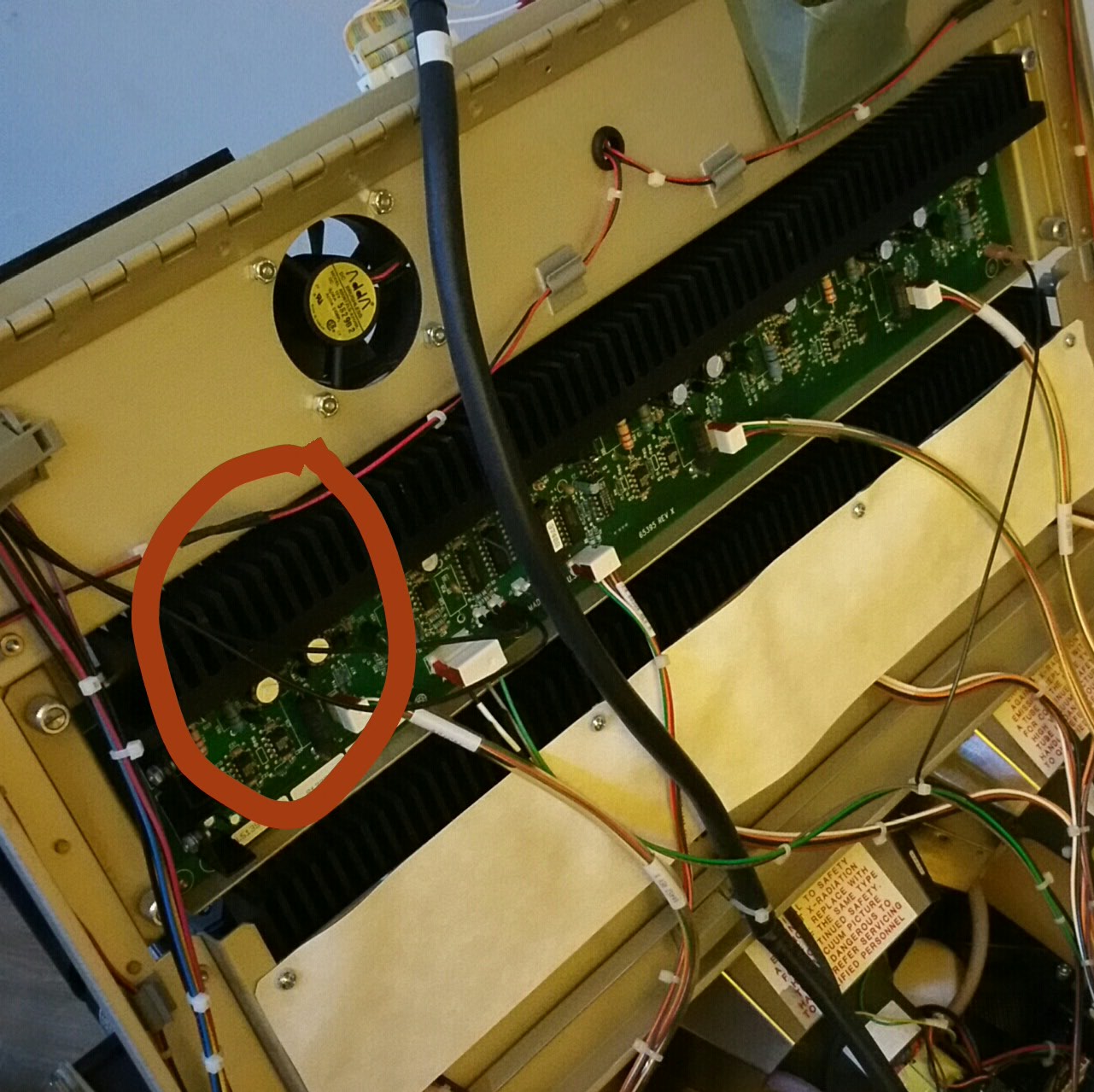

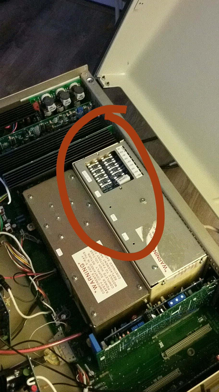

Posted: Sat Mar 07, 2015 7:14 pm    Post subject:
Device reads memory failure. Because battery is dead.
However, I can turn it on, tubes get power but no fans run and smoke came from these two locations.
It does not smell burnt, it's different.

Posted: Sat Mar 07, 2015 7:28 pm    Post subject:
Makes me wonder if it was more then a demo for the importer, like a parts mule. I've had them before.
