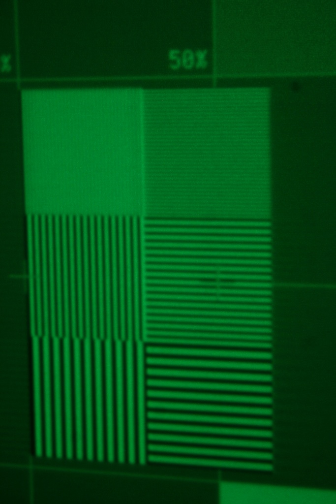

Can anyone with an XG tell what settings they are using to get rid of streaking on an XG running 1080p. I am using a VP50 and a Moome ext V3.
Thanks,
Greg

Streaking is addressed to improper display timings, however I don't see that on your picture. Those bleeding horizontal lines are more or less normal, but they may indicate some weak capacitors in the RGB power supply line too.

Thanks gjaky.
Its probably time I run an ESR meter over the boards.
Greg.
