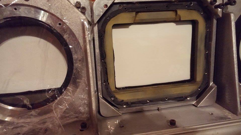

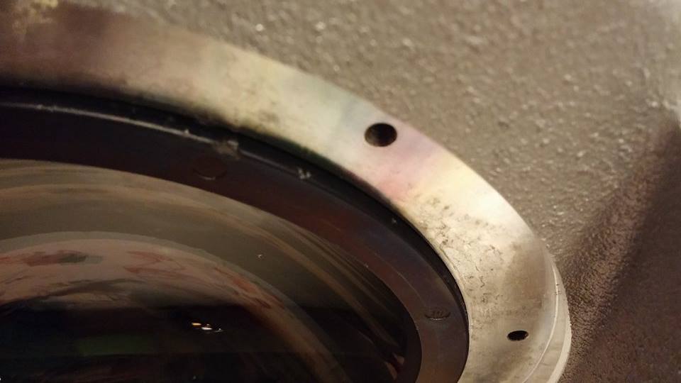

1. The green CRT chamber was packed with orange goo, after the coolant was drained.

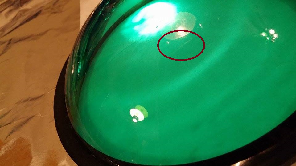

During removal of the C element, it slipped and tapped the bottom edge of the chamber. This resulted in a scratch on the C element,
A. Is the scratch going to affect clarity? It took a bright room and a flashlight to get this scratch to photograph.
B. I have scrubbed the CRT and the frame continuously with 91% isopropyl alcohol, but the orange goo is slow to remove. I haven't found any similar cases online to follow as an example.

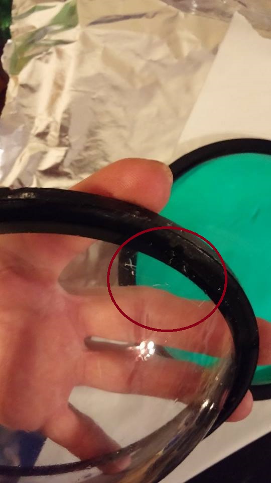

2.During removal of the blue CRTs clear C element, the side was nicked.
A .Is this harmful to the C element in anyway, as far as diffusion ability?
B. There are pre-existing scratches on this C element. Can it benefit from a replacement?

Green C Element with scratch highlighted.
 Filesize:  83.56 KB

Green CRT and chamber after cleaning.
A haze is still visible.

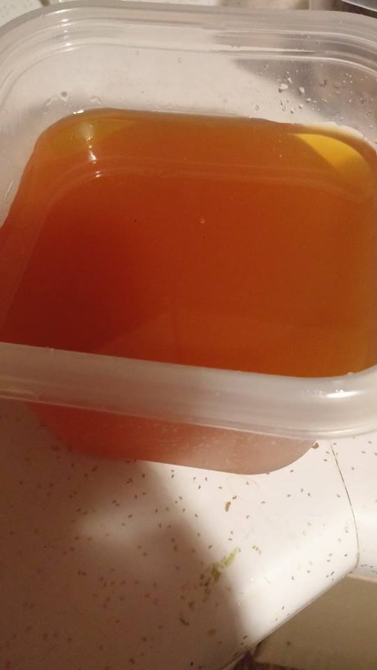

Removed green CRT coolant.
 Filesize:  27.38 KB
 Viewed:  3393 Time(s)

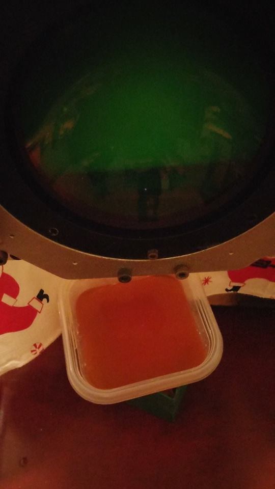

Draining coolant from green CRT.
 Filesize:  33.41 KB
Tooling marks on clear C Element edge
 Filesize:  39.26 KB

Regarding the scratches on the C Elements:
Scratches, dirt and other defects will only show on screen when present on a surface where the projected image is focused (focal plane). As far as I know for the C Elements this isn't the case so You should be fine.
Regarding the dented edges on the C Element:
Dents on the outside (the side where the metal ring with the four bolts goes) are almost never a problem as there's a lot of surface contact between the ring and the C Element. Dents on the inside can cause leaks if they are too large as this is where the bellow seals against them. In this case I'd look for the chopped-off pieces, glue them back in with superglue (cyanoacrylate based glues work well) and smooth the surface (sanding&polishing) around the glued-in piece. Otherwise it might be necessary sealing the C Element with RTV against the bellow.

Replace the fill screws and rubber washers at the top of the tube, that's where the discoloration is coming from. I've got stock, as well as glycol if you need it

I think it be fine, the scratches on the edge should not show up in the image and as said earlier it is out of the focus plane so it should be ok.

I did some tests with a diffused LED. The clear C element seems to be just fine.
I'm not so sure about the green C element, however.... I'm going to try to reproduce the same sort of output expected from the tube face, and the same distance as the tube face and the C element, a little more accurately, before I make a decision.
I cleaned up the chamber as best as possible, without sanding. I'll be coating it. I think I found the weak link in the chamber. Down to bare metal at the bottom.
Still need to get the old RTV off.
