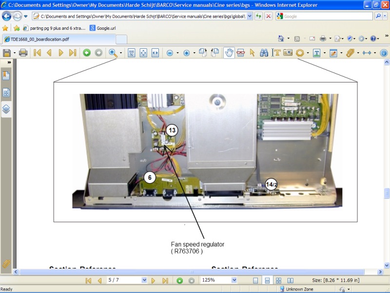

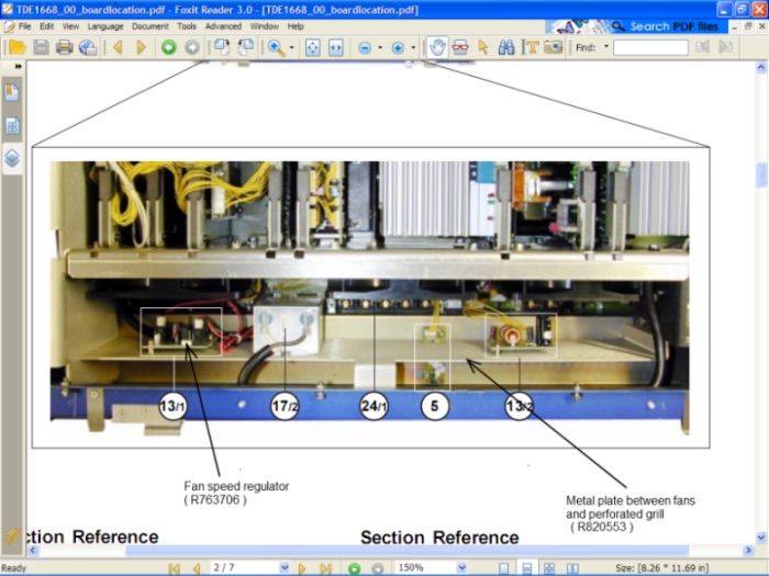

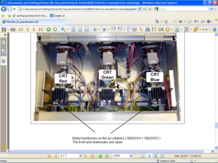

True. Because no one wants a hoovercraft in their living room, Barco had to redesign the fan circuit on CineMax/Cine 9. Three major changes were done:
1. Two fan speed regulators ( R763706 ) were added like Case mensioned. One for the two front fans and one for the back-left and back-right fans. The back-middle fan remains controlled by a thermal sensor in the SMPS module, like in 909 ( when starting the projector, it is normal for the back-middle fan to not spin yet. It will start to make noise when the temp. increase ).
2. The air turbulence was reduce by adding metal baffles. A plate on the back, between the fans and the perforated grill and two mini hush-boxes on the laterals.
3. Software limitation of the maximum horizontal an vertical scanning frequencies. From 180 reduced to 132KHz horizontal and from 240 reduced to 210 vertical. This way, the very self protective chassis ( controller ) won't generate a fan-fail.
So even if those two boards and baffles are installed, the controller has to be flashed with CineMax/Cine 9 software in order to work. Not that simple, unlike other projectors where a EEPROM change will do the job, here is done with a PC and Barco Explorer program. There are riscs, a tinny interruption in data can make the controller unusable.
Curt has some experience with soft. flashing on Cine 9 but that involves sending the controller to him.
