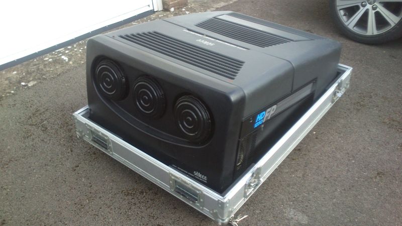

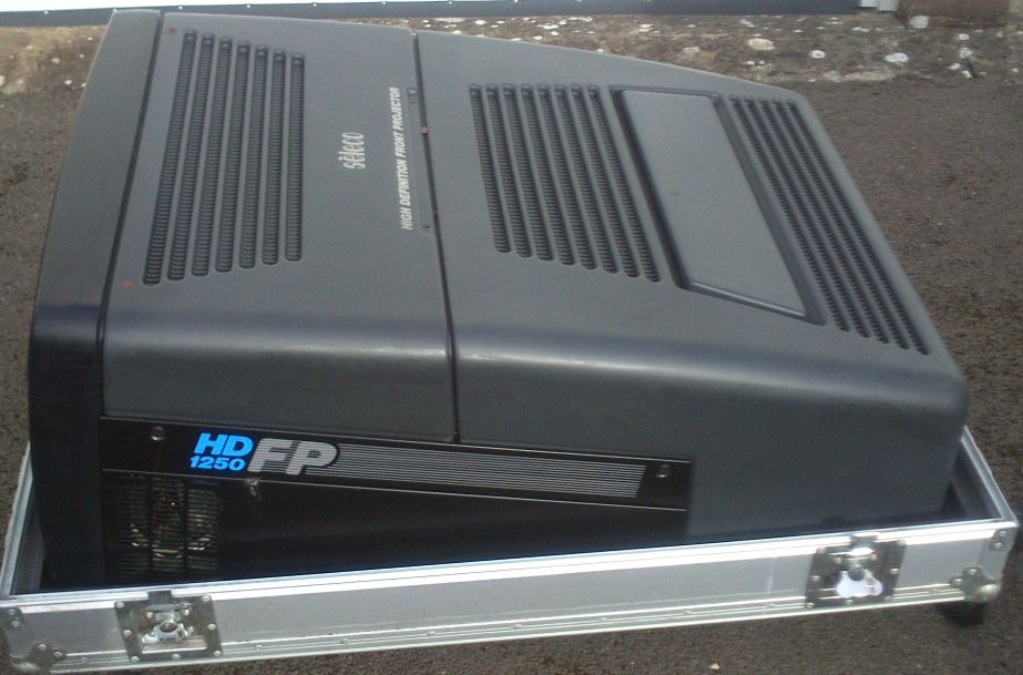

Side view
 Filesize:  82.77 KB
 Viewed:  9575 Time(s)
Front and side view
 Filesize:  68.27 KB

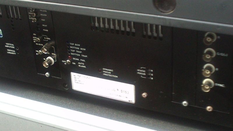

Rear inputs
 Filesize:  46.24 KB

Oh, and the dynamic focus protection LED makes me think it is an EM machine, all other seleco I know of are ES focusing machines...

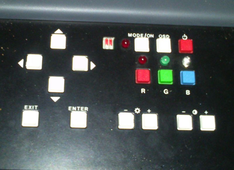

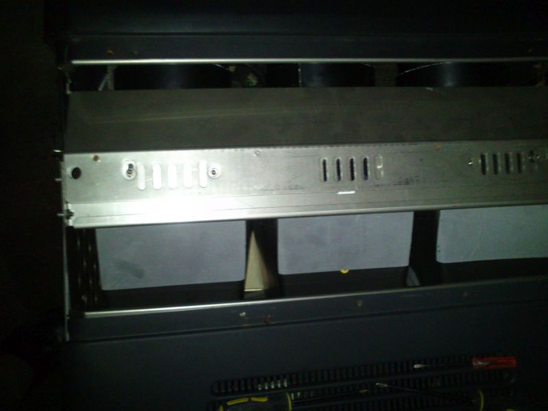

So I've had the top off. Inside are Delta HD10 lenses, but the tubes are covered by a thick plastic case over nearly the whole length, with a strip of thick tape (metallised?) over some of the top. The remote situation is a bit more encouraging... there is a flap on the top that reveals some buttons and a couple of micro switches. It has R, G, and B buttons, so maybe setup is possible without the remote?
Control panel
 Filesize:  54.69 KB
 Viewed:  9252 Time(s)
Covered tubes
 Filesize:  41.87 KB

Posted: Thu Feb 05, 2015 9:33 am    Post subject:
Should be enough there for a setup, try running 800x600 in from a computer and see what you can adjust.
