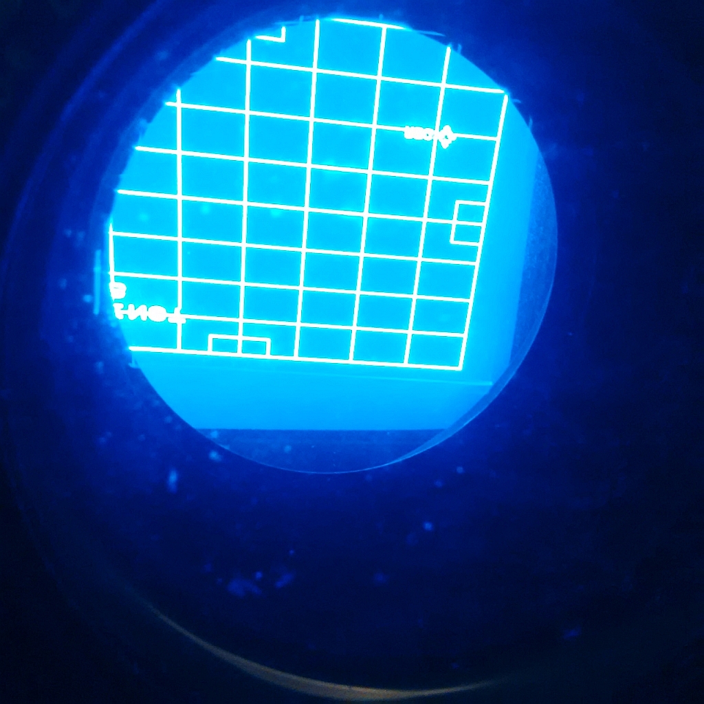

Hey Guys !
I found an Sony VPH D50 HTM for a few euros which is in really nice shape, Tubes look almost mint.
But it has some strange issue...
The Blue tube is overbright with the Bias Control not making any visible change.
You can see on the Photo an Horizontal line under the Grid maybe it helps identify something.
After an hour or so i noticed an high pitch sound around the Area of the Blue tube.
Found a similar thread from somebody else, but itīs not exactly the same phenomena i have thatīs why i opened a new thread. Could it really be a neckboard? Or Tube itself?
Cheers for any advice
Ronald
Btw. donīt mind the Dirt the lenses are full of Dust..

Posted: Sun Jan 25, 2015 4:36 pm    Post subject:
@everyone
If anybody has a similar Issue sometime, i kinda solved it.
The PA Board was the Problem i swapped every other possible part out without solving it.
In the end some resoldering on the PA Board seems to fixed it for now.
