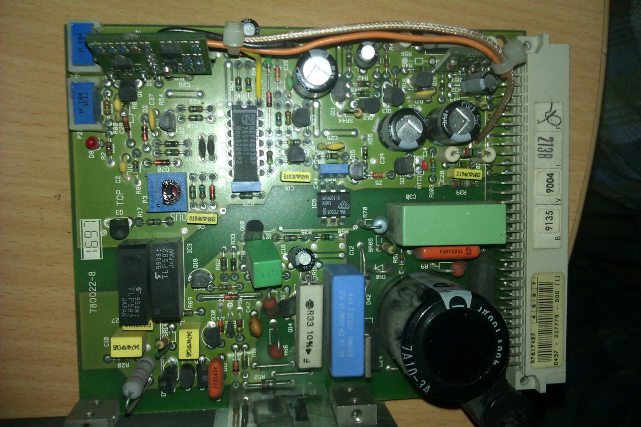

Approx. Thank you for the advice. I wonder all the time. My barco 808s is probably broken a few items, but has a very good light 9,9,9. Convergence problem. I replaced two albums convergence / management and driver /. Next the same thing happens. I can not bend only points to the left and right on a red . Numbers, but nothing is regulated on the screen. H-size - it also does not work. Green and blue is good. I can not deal with it. Sony G-70 has an error 29. broken plate B, BA - RGBHV input. Not here to buy, or is very expensive. G70 lamp - 8,7,8. Waiting until someone is cheaper g70 sold for parts. 1281 Mitsubishi projector never used I thought it was a good idea. Smile I am a loyal CRT. I do not know why, but I can not convince the middle class LCD and DLP projectors. For jvc DILA I can not afford. I gave him one last chance Barco 808s. I'll take two of these projectors damaged. They have them in the company of "Barco" in Warsaw. I'll be good consisted of three broken. I'll see if it succeeds. greetings

The 808 only needs a convergence board by the sound of that....

Hello. 1281 Mitsubishi did not buy it. I listened to you. Barco fix my 808s, but I do not know if I can. My 808s Barco is damaged: 1 / power supply, 2 / motherboard-burning . 1 Picture of my projector. 2 picture i have two 808s Barco damaged Date. All three projectors are 07mfp tube - p16lkg ..... The truth is that I do not know what my projector model 808s Smile Date barco 75MHz? or Barco is 808 s 120MHz graphics? After what parts of it can get to know ?? If you can not run any of the projector.
question:
Defective motherboard in my projector is R762502. I wanted to replace it with another number R7625021 from other projectors on the photograph 2. Can I use the old type quadrupler + old type EHT on the board R7625021 ??
I only have one set of active old type EHT + quadrupler. Two efficient motherboards R7625021 and one power supply BGR 808s/E.
Sorry for my English, I do not know if anything can understand / Google Translator / Greetings and thank you for your help

Ok. I know that I have to do combinations of "new frame set = old quad + old EHT + any splitter (JUMPER)" Who me explain .... "Jumper". How do I do this ???? Where is it?

Posted: Mon Dec 22, 2014 2:41 pm    Post subject:
Jumper is an hardware modify on eht board

Posted: Mon Dec 22, 2014 9:49 pm    Post subject:
Approx. Can you tell me how to do it? draw on the photograph?

Posted: Tue Dec 23, 2014 9:05 am    Post subject:
I believe that jumper is on the Frame between/near the quadrupler and EHT. The bulletin below helps.

Posted: Tue Dec 23, 2014 3:18 pm    Post subject:
Unfortunately, I know nothing more Sad Does anyone of you did on the projector jumper ? Can someone take a photo or drawing ??? Only it saves me Sad
Posted: Tue Dec 23, 2014 9:35 pm    Post subject:
Perhaps the best way would be for someone to help you. You need access to the under side of the Frame between the Quad and EHT and its difficult to get to. As Decibel says you could modify the EHT but this is more complex. Is there anyone close to you that understands a little about circuit diagrams?
