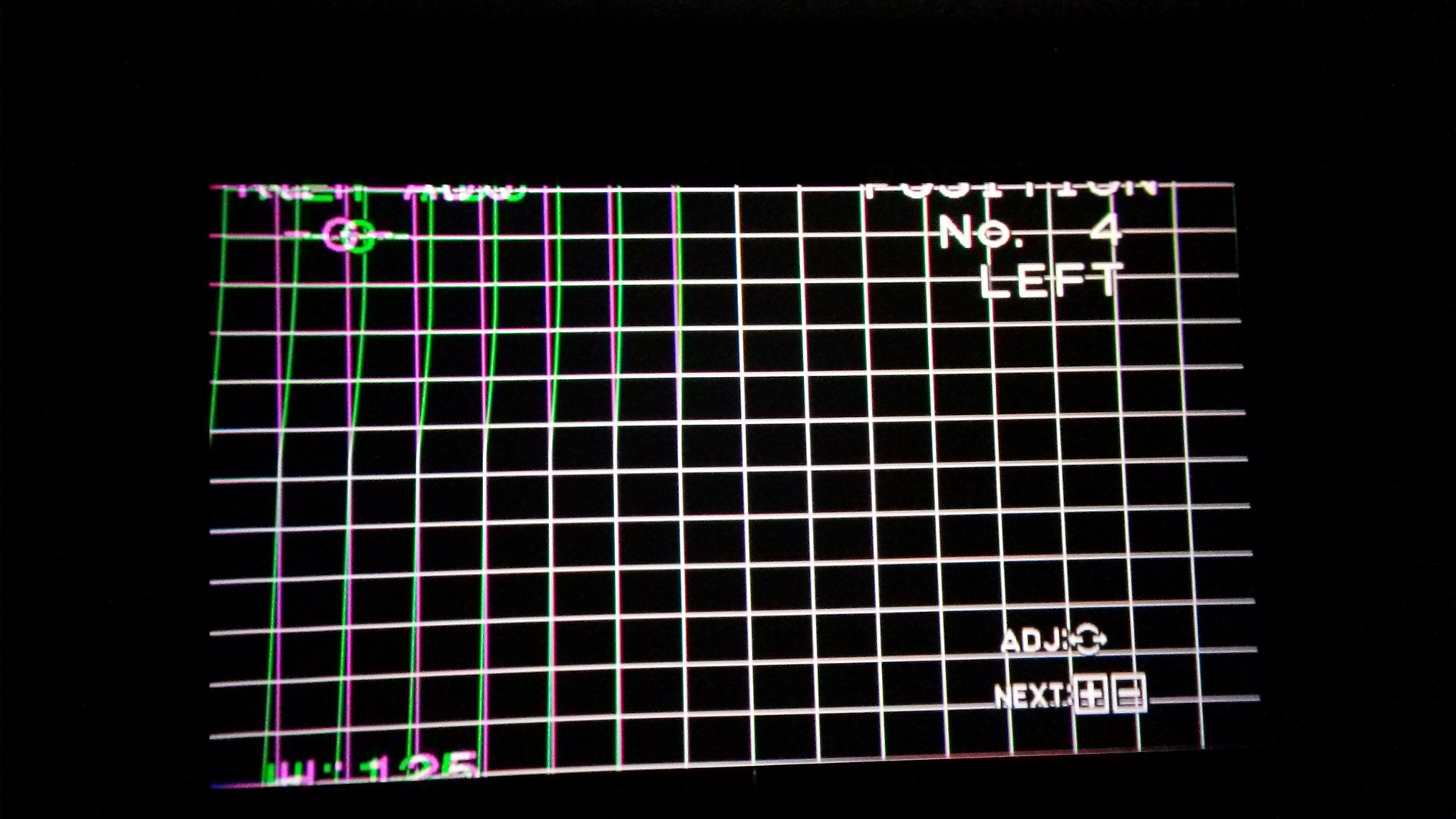

Posted: Mon Dec 22, 2014 12:36 am    Post subject:
CIR Engineering wrote:
olakjen wrote:
thanks that helped , the blue gamma curve is to high and it is not possible to straighten out whit original gamma adjustments , any ideas ?
Do you have blue "standard defocus" turned on or off? I would suggest just leaving it turned on. This will allow blue to track better.
You could also consider turning blue defocus off and defocusing blue manually. Use your color analyzer to measure the light output of blue with blue tightly focused. Then adjust blue to defocus enough to reach 20% more light output from blue only.
If none of that works well enough for you, than you can adjust the blue gamma. Go into the G90 "expert mode" for this adjustment. To do this, first enter "service mode" then enter "expert mode" by hitting ENTER > ENTER > LEFT > RIGHT > ENTER. Once in "expert mode" you can adjust the gamma of red, blue, and green separately. To get to the gamma adjustments press "Bias" and "Gain" on the remote at the same time. Write down your original values!
craigr
that helped allot, but now a have a new problem when a watched a movie and suddenly a weird sound from the projector
and the convergence on the green goes off on the upper left side of the screen , and then the zone and key on the left
side dont work
