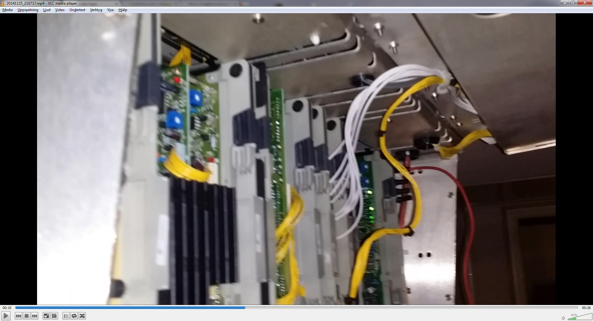

Hi!
Something is wrong. The pj turns on, fans spin, but then the standby light starts to flash in sync with an audible HV noise and also in sync with the LEDs on the G2 diagnostics board (some green and one red) and the H output board (one red). All (or rather most) LEDs go on and off a few times (in sync) and then the pj goes back to standby mode.
I've tried another quad. Didn't help. I also tried a new EHT , G2 and H board. Didn't help. All "symptoms" are the same, still.
Any ideas from you guys?
Thanks!
BTW, I have a short clip showing the problem, but the file is around 50 Mb... I'll post some pics showing the LEDs ("on" and "off" states).

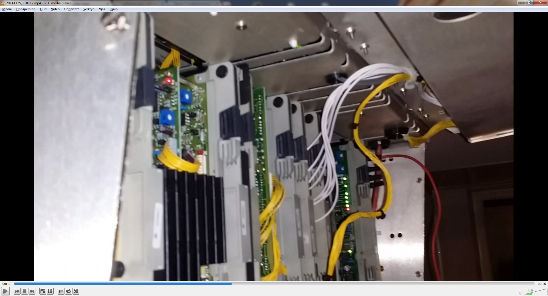

Second pic!

OK, as promised. you have no picture due to the lights on the G2 board, first picture, far right side. The red scan fail light is on, because a couple of the power supply voltages are missing, as per the two green LEDs that are out.
Turn the projector off, and watch the green LEDs when you power up. Do they all come on when you turn the projector on, or is there one or more that always stay off?

If I count correctly, there are 10 LEDs in total (the red LED is the second one from the bottom in the above pictures). If so, LED number 1, 7 and 9 are always off.
I hope this helps. BTW, you might have been contacted by a friend of mine who also lives in Gothenburg, Sweden. He is also helping me with this...! Smile
