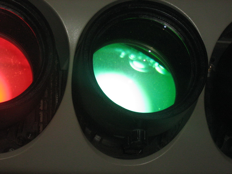

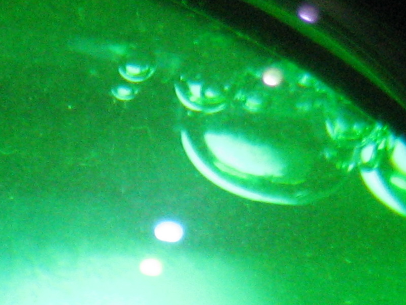

Did you know a friend, what are these bubbles on green lamp
of my G70;

Did the lenses see sun? That looks like burnt C-elements
Posted: Tue Oct 21, 2014 9:31 pm    Post subject:
It's possible, but they look more like actual air bubbles to me, trapped right at the edge of the LC chamber.

No, no SUN! the pj have 17000 hours!
Posted: Wed Oct 22, 2014 5:59 am    Post subject:
Check to see if there is any glycol leaking into the chassis of the projector under that tube. I would agree with SC they do look like air bubbles.

Remove lense to see if it's air bubles inside c-element or crack in glass lenses edge.

Yes! tnx!
