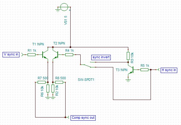

I considered pulling in the fifth cable as a PITA because the cable I used was special and to match for the rest I would have to order more. While I looked up the google for circuit solutions I realized that all of them are far "over complicated" built off logic IC-s. I didn't have any of those desired ICs either. So I decided to build my own comp sync + invert circuit from what I have. It consist of three generic NPN transistors and a few resistors. It works.
Composite sync "processor" + H sync inverting switch

He when I look at the schematic there is a 5 V on the top? Where did you get that from? PC?
Posted: Wed Mar 25, 2015 6:13 pm    Post subject:
Most (modern) videocards sends out 5V on Pin 9 on the d-sub connector, that was originally a dummy leg.
