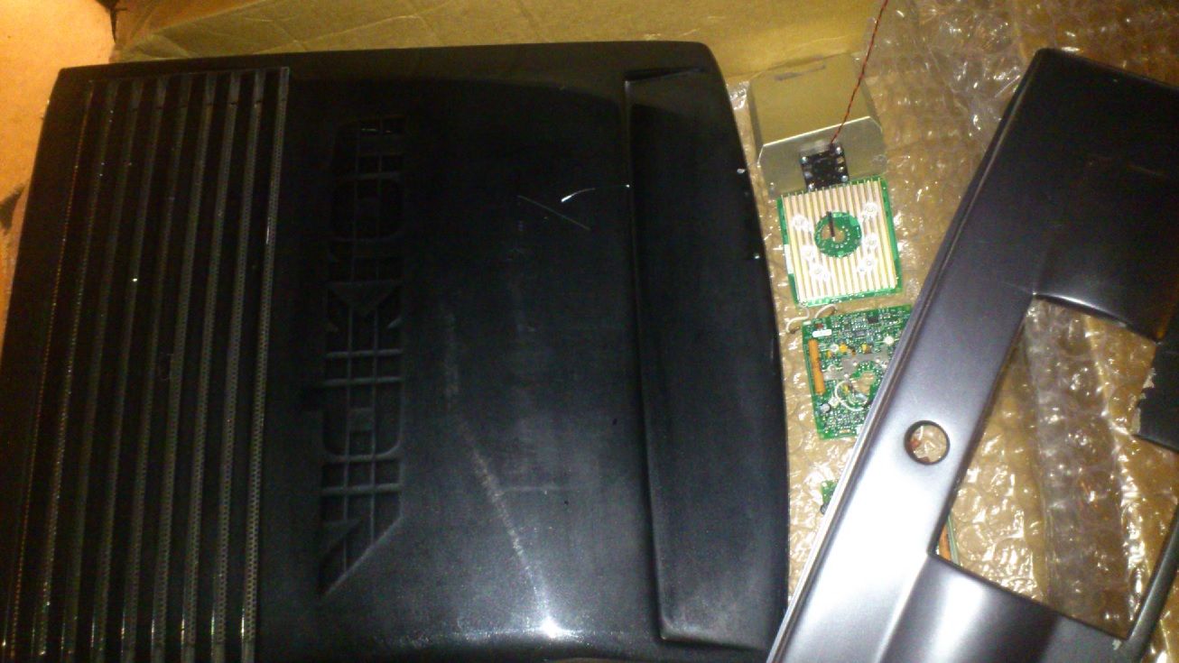

Yeah, my Ultra parts are here, and I have to say it, they really look super-clean and new to me. I can't believe they have thousands and thousands of hours on them.. especially the neck boards look all new. No filth at all.
Anyway, parts arrived neatly tucked in, with only one neck board damaged with broken pins and a loose cap, other than that everything else was intact. I bent the pins back, and can always use one of my old once for the time being or until I soldered a new one on there, which even I should be able to do.

Damn that thing took a hit! USPS is getting pretty bad lately, but at least the case turned up intact! I was far more concerned about it than the boards. Let me know if you need replacement caps, I have lots!

Yeah, it was pretty beat up I'll tell you. If the box was custom made and new it sure is soft and worn now. No tax though and delivered all the way to the door.
I can take a picture from the neck boards I have and you be the judge whether they are of the same sort or not. I would like to change because mine are really worn and filthy. Solder joints look brown on some bits as I recall.
But thanks for padding them up so good, it 's not your fault one got damaged, one of those things that happen.

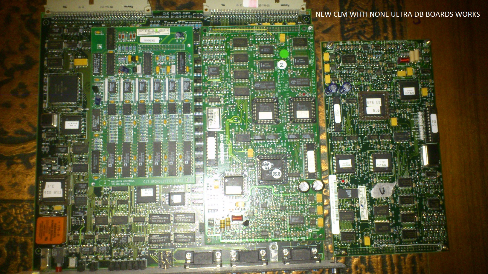

Ok, good to know. Thanks. And for your information, my problems has been reduced to the big DB board and the chip U7 V5.6. That's the culprit. I thought it was malfunctioning at first but is becoming clearer now with what you said.

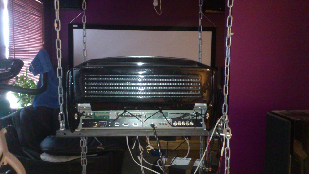

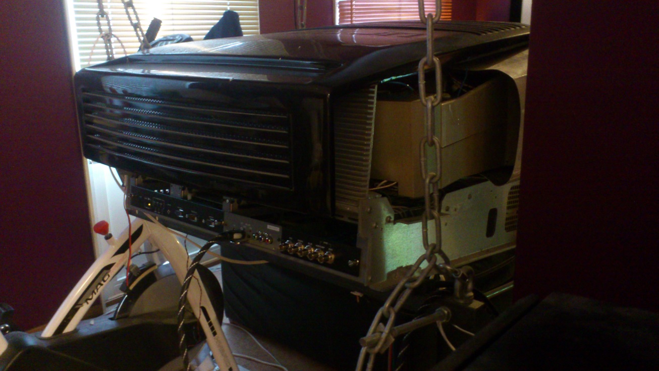

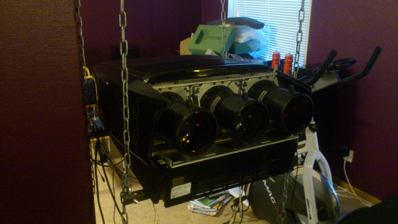

Anyway, I have made the swap now, and it's running fine with the new neck boards and a mixture of old and new CLM parts. I'm actually still using your modded HDM, Dragan, and it works, but may need to change it when all the parts are here like you said. I have 3 different CLM, and the new CLM behaves very different with each of those DB:s. One even makes the LVPS to go out with a ticking sound. That may be because some CLM require the fans to be connected? I have them all unconnected and run them from an external source to lower the fan speed to 9V.
Sub brite on blue and red works though.

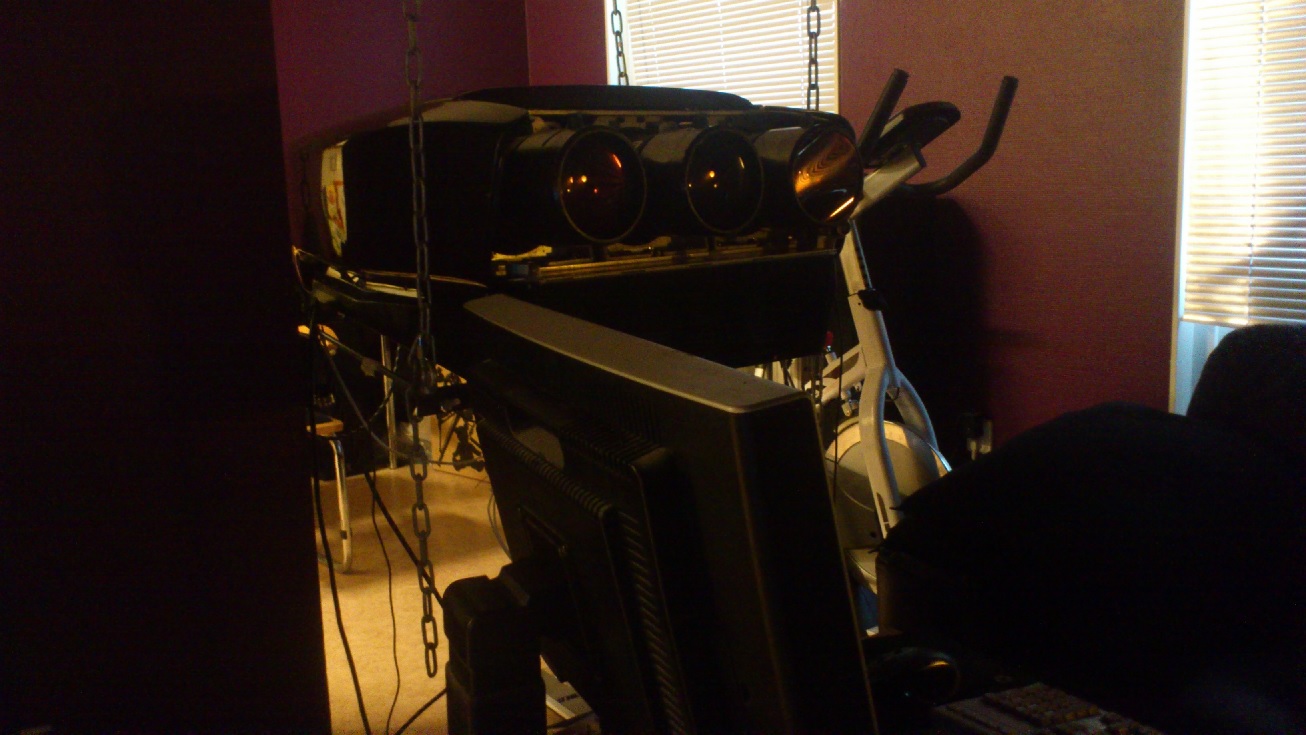

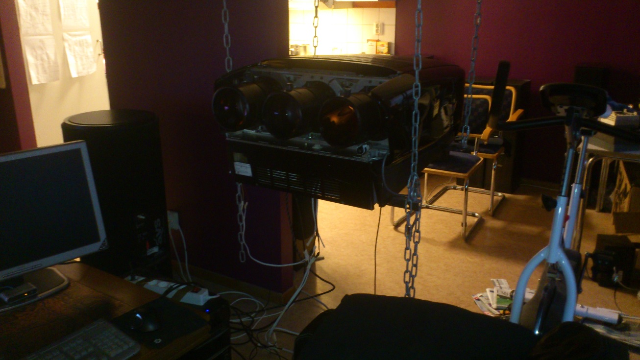

The FGM had to be removed, but got to see some new features before I had to take it out. But the pj sits almost in the middle and I want to raise it 4 more inches to make tubes levelled and aimed at the screen mid point and not the chassis. Some day.
Before I had contrast and brightness set to 65, on both, but now it's 65 on contrast and about 18 on brightness. I'm going back and forth to find the old settings as it was very bright early on.
And I really like the new casing. I almost having second thoughts about vinyl in a different colour as I envisioned. Black is cooler than I thought..

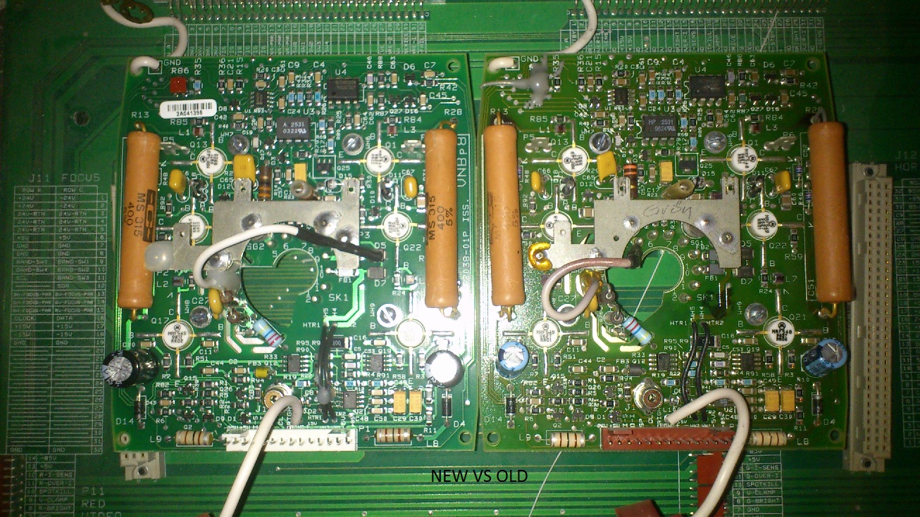

Posted: Sun Oct 12, 2014 9:36 pm    Post subject:
yeah your old neck-board is bad, it has the undersize capacitors on the power rails and the big resistor is starting ot burn the board at the top connection. Good thing you bought new ones. Luckily this one thing VDC did fix

thewolfman wrote:
Ok, good to know. Thanks. And for your information, my problems has been reduced to the big DB board and the chip U7 V5.6. That's the culprit. I thought it was malfunctioning at first but is becoming clearer now with what you said. Anyway, I have made the swap now, and it's running fine with the new neck boards and a mixture of old and new CLM parts.
Hehe, cool...
The replacement DBP (with U7 V5.3) was one of the spares that I had refurbished and modified. I recognize it from the green round sticker and the white "2" sticker. Glad it works for You!

Cool! I hope the v5.6 chip will work later when the last remaining parts are here. The best part of it is that I got improved sharpness with these neck boards, and even got rid of that smeared section that always plagued me on the mid half of left side. It's always been there before but gone now. The sides and edges really cleaned up very nicely to. Smile

I see, you sit central, under the pj. Wink I like your thinking, best seat in the house - that's the way I'd do it too! Yes, jack the back up to negate the tube/lens angle (although it already looks less than on a Barco) to use full phosphor area and zero keystone that was my thinking too for a perfect install!

I agree, best seat in the house. Smile
Well, almost, even if I raise the front by like 2-2,5 inches and maybe 4 in the back to make tubes levelled, my head will just about go under it - or not - but a recliner outstretched mat solve that. That's the long term plan anyway. And also make Uni-struts, just like Redfox has done recently, to also be able to back up the projector sometimes. Custom porches and all that forces me to redo it often because it doesn't fill up the screen, but other than that perfectly centred in the screen rendering no use of phase at all. That isn't always the case, because sometimes it's off to the right or left and I get banding with phase. It can't be a coincidence. The other thing I want is a Bosh Quigo 2 laser to make everything super straight to the mm on all axles.

[ The best part of it is that I got improved sharpness with these neck boards, and even got rid of that smeared section that always plagued me on the mid half of left side. It's always been there before but gone now. The sides and edges really cleaned up very nicely to. Smile
half the improvement people get from the HD mod's is the neck cards since a lot of them look like your old ones. Getting them back to proper condition is step 1 , filtering some of the noise is step 2 . Look at your old card, the black heater voltage wires carry a lot of noise and they're smashed flat down onto the video signal circuitry. VDC puts a spot of glue there now (other pic), but really the wire should be put on the other side and a choke added.
