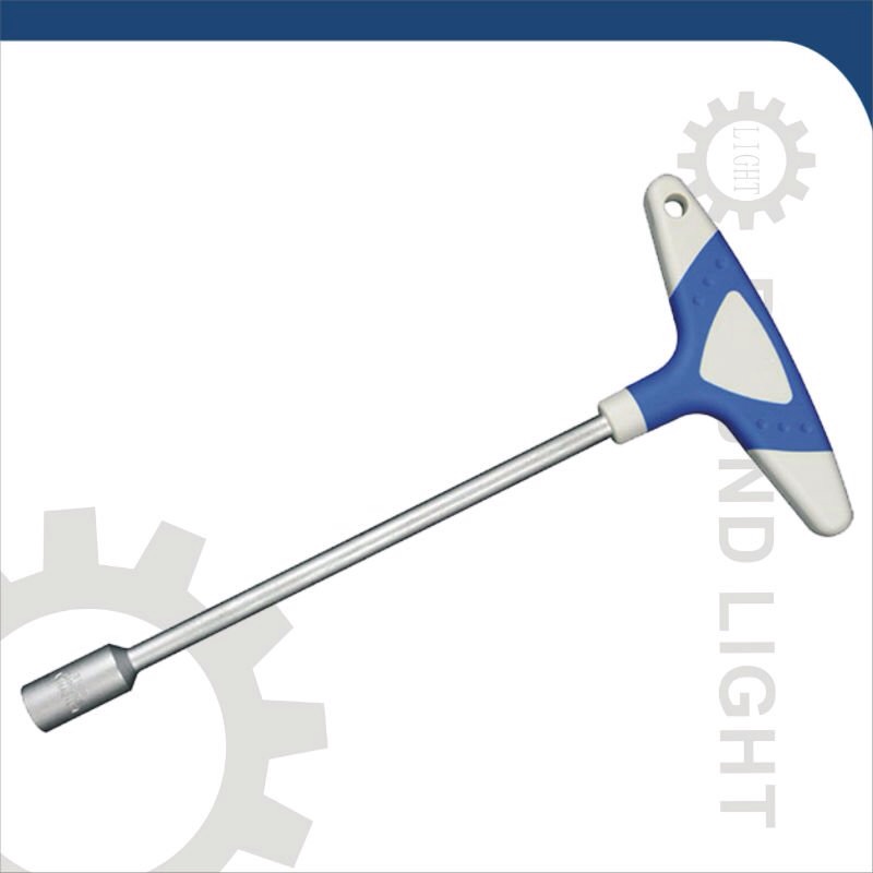

It's not a allen key you need to remove the lenses. I use a 8mm T-handle nut driver for the job. Make sure is long enough to be able to use it without touching the lenses with your fist.[list=][/list]

nut driver? The HD10's on LC marquees are held on with English 8-32 socket head cap screws which take a 9/64's hex (Allen) key. The 8500 is different, it uses 10-32's and takes a 5/32's hex key.
The T-handled tools are the best, you want the 9" long version and I prefer the ones without the ball tip for projector work,
Mcmaster carr has nice ones with rubber cushioned grips for about $2.40 each
