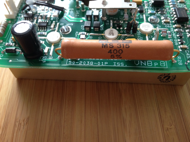

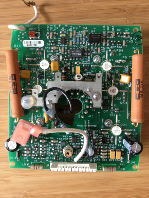

Is this an old style neckboard? Is it LUG? Does it have Motorolla transitors? Q1,Q21,Q14 are sure Motorolla. I see some other Motorolla parts.

In fact the MP neckboards have the number 2039-01p. So the 2008 boards have the number 2038-01p. On AVS tse says the only difference is the cutout.
Posted: Thu Sep 25, 2014 11:25 am    Post subject:
They are perfect. Was just thinking it was the new type when they had the ventilator. And you told they were from 2008.

Yes I don't get it either must be using old style neckboards again? Thanks!!! Very Happy

One of the transistors says MS549 and there is an APT mark on it. The others say MF549 with the Motorola mark. The MP neckboards have MF549 on the place of the MS549.
I could not find anything on MS549 but I guess it is a replacement that has the same performance? Anyone knows?
Posted: Thu Sep 25, 2014 12:14 pm    Post subject:
Yes thats a replacement transistor, i have a set of neckboards like that from my 2004 9553LC Ultra.

Ok beautifull design these neckboards no problem there even the caps are 105c already on this version.

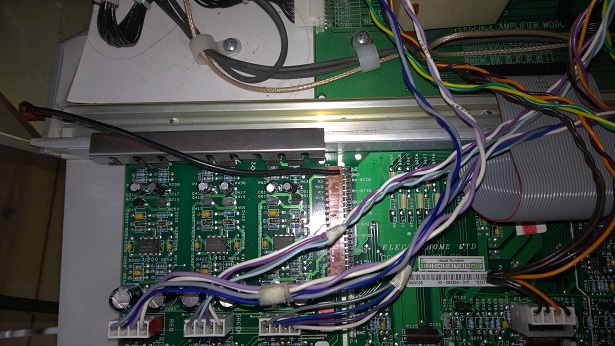

But I could not find the exact information on the 'ground strap mod'. I think it has something to do with cooling the neckboard better? Do you have any more info or links?
Posted: Thu Sep 25, 2014 12:57 pm    Post subject:
wait a bit ill take or see if i can find a pic, it has nothing to do with the neckboards.
Posted: Thu Sep 25, 2014 1:30 pm    Post subject:
Here you go.
 Filesize:  138.3 KB
 Viewed:  11274 Time(s)

Ok thanks! Will try that with and first without.
