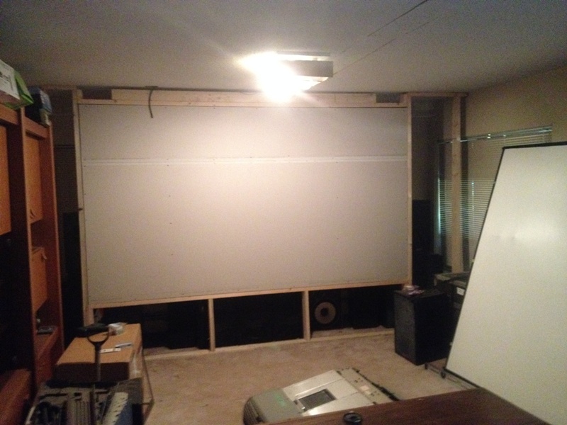

Given that I've got a tiny bit of cash and some downtime, I was gonna keep this secret, but alas, I cannot!

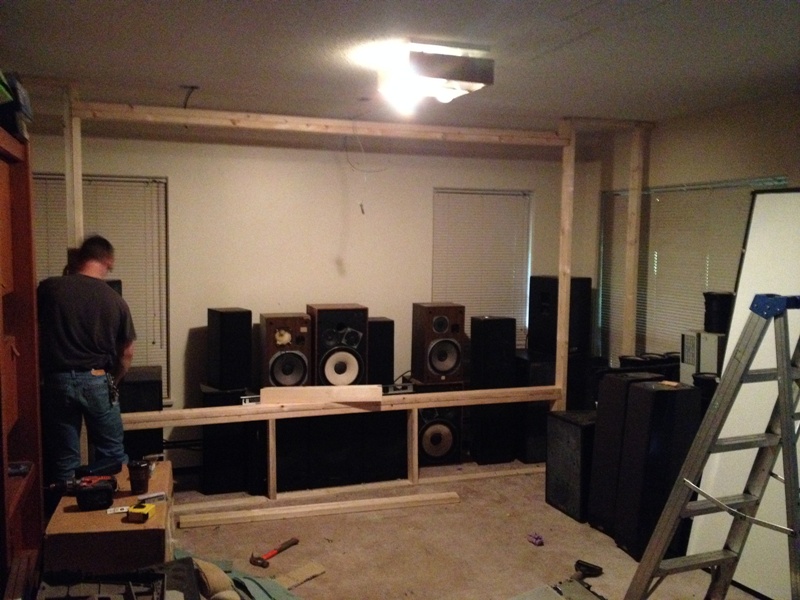

Started on the HT, first time in over 6 years that pix will shine on a new screen. I'm going to stack Barco 909s with used tubes for now (very light wear), side by side, on a 10' wide 16:9 screen. As you can see, the room needs a LOT of work, but we started by building a frame for the screen. Simple 2x4 construction. The (for now) drywall screen is going to be mounted on a sub-frame that will be tacked into the main frame area. That way, when I can afford an acoustically transparent screen, I simply go behind the wall, take out 8 screws, and pop the whole drywall screen out. Smash out the drywall, put on the new material, and pop it back into place. that's the idea anyway. The area around the screen will be more 1X1 frames covered in black cloth. Removable via Velcro to access the area behind the screen.
DO NOT poke fun at my wall o'speakers. They've been stored there for 10+ years. Just ordered a tweeter for the Yamaha. There's also a GE Talaria projector in the corner. Smile
I am using a 3X12 Tannoy subwoofer that handles 1000 watts RMS. LCR are EAW 12" 2 way PA speakers. There's also a set of Community speakers there that aren't being used, and need a small club to be installed in. Not sure on surrounds yet. Right now I have a 5.1 receiver, but have a couple of Onkyo 7.1s to replace it with, pending if the HDMI switching works on them.
The back wall and entire ceiling will be covered in 1X1 frames, with black cloth stretched over them. That will eliminate the ceiling from needing to be patched. It also allows for future wire runs to be added or changed. The room is pretty live, so I'll play with sound absorbing material and bass traps as time goes on.
The teak wall unit is staying for now, but will most likely go away down the road, and move to the living room. Carpet will be changed at some point in time, and will be black.
The entire room is run on 1 15 amp circuit. I've run 2 more runs of 12/2 wire, I just need to find room in the breaker panel and go with a couple of 1/2 size breakers to make everything fit.
Hope to have the screen drywalled and drying tomorrow, just waiting for my buddy to show up, as I can't hammer a nail in straight.

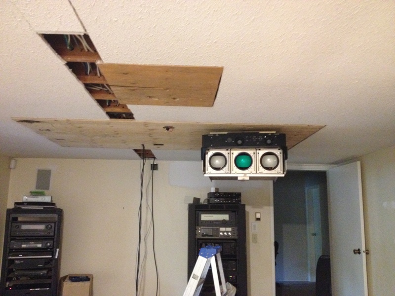

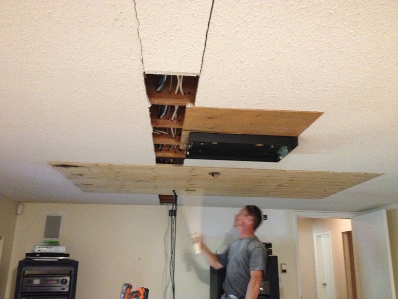

Drywall up, ready for mudding. Will be painted matte white, nothing special for now.
Barco 909s will be held up by a 4X8 sheet of 5/8 plywood.

Got a green C element in the one set, haven't started working on the second one yet. Might get one set on the ceiling tomorrow, but probably next weekend. I'm in a training session all week, so nothing will get done this upcoming week if I don't get it done tomorrow.
Posted: Sun Sep 21, 2014 7:16 am    Post subject:
Well pull ya bloody finger out mate!!! You using a MOOME or something else? CM-101 mounts?
And while youre at it, we will be needing to see some 1:1 shots from your setup with one and both machines for my Barco 9" thread Wink
Posted: Sun Sep 21, 2014 4:53 pm    Post subject:
Whoa boy! Smile
Gonna try to have one machine up by the end of the day, but it may not happen. Can always pull out the red tube while it's on the ceiling and put in a red C element.
Drywaller is here again this morning doing more mudding, and paint this afternoon.
Original Barco mounts, whatever they are called. Will run HDMI out into a Moome box, then out to an RGB splitter at the projector. Cliff says to send Mike my NEC ISS switchers, but that's low on the priority list. Hell, having even a converged picture in my HT room will be a treat after 6 years. Stupid thing is, I bought the house based on the room I have never fully set up, go figure. (actually, location, house size and lot size also played into the purchase.)

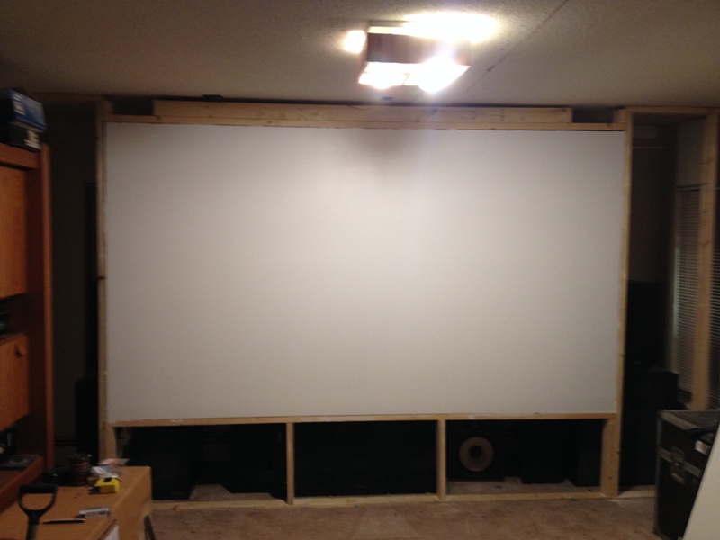

Posted: Sun Sep 21, 2014 10:44 pm    Post subject:
Painted!

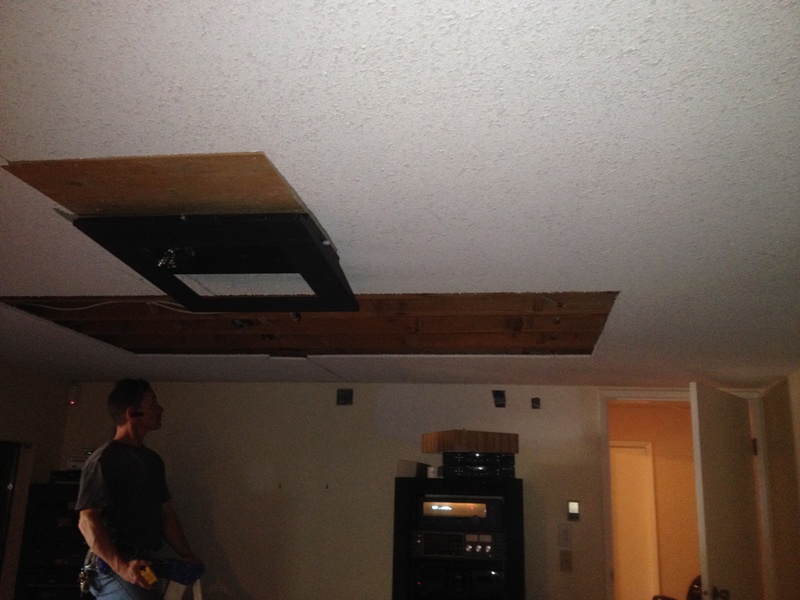

Posted: Sun Sep 21, 2014 11:22 pm    Post subject:
Plywood up, held up with 48 #10 X 2" screws.
