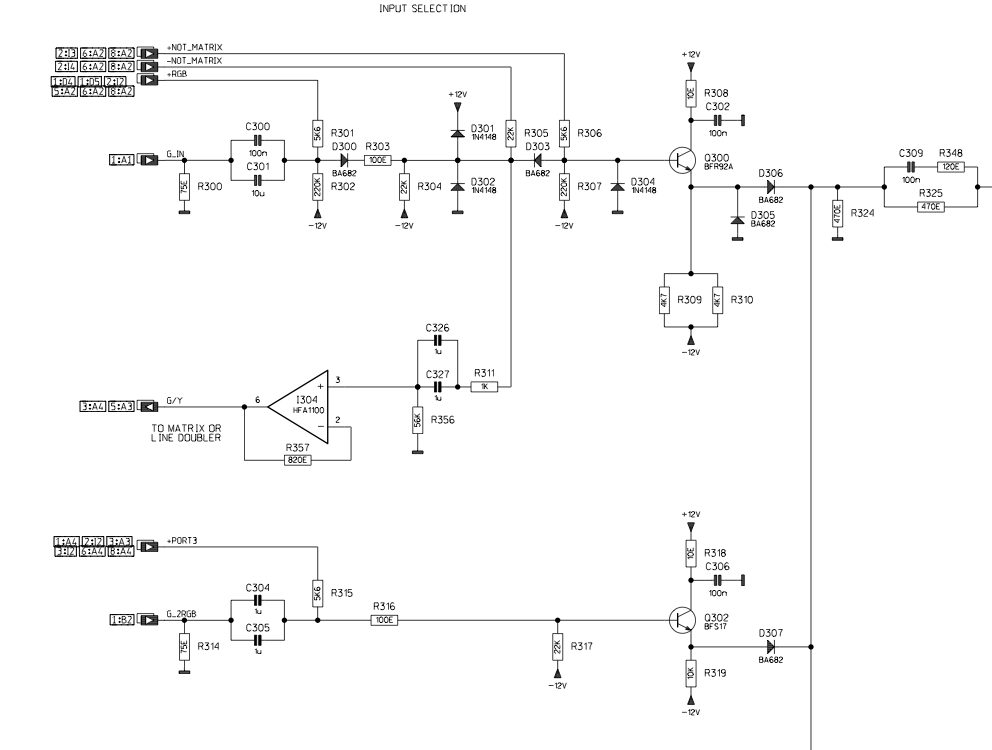

I think you might have the right remark for why the video mods add something in the case of Francisco. He made the port 3 transistor equal to the port 5. I think that is the most important step. It explains why we never saw a 1080p resolved because we used internal port 3 hdmi or the moome/hdfury external and all three ways don't work. (This is apart from the mods lowering the noise)
Seems like the 909 is capable to resolving 1080p@60 with the right input on port 5.
I have to add that I tried a vga adapter that was less good. A crab vga card that was even worse and a geforce 9300 that did not want to sync. So I guess Casey has the right top Geforce video cards and produced these pictures more than once.
Now I do wonder how the new Moome hdmi will look on port 3 with only the transistors changed.

Look at the differences between port 5 G_IN and port 3 G_2RGB. Port 3 has as only difference the BFS17(1GHz) and port 5 has the BFR92A (5GHz). After that and before that they are the same.
