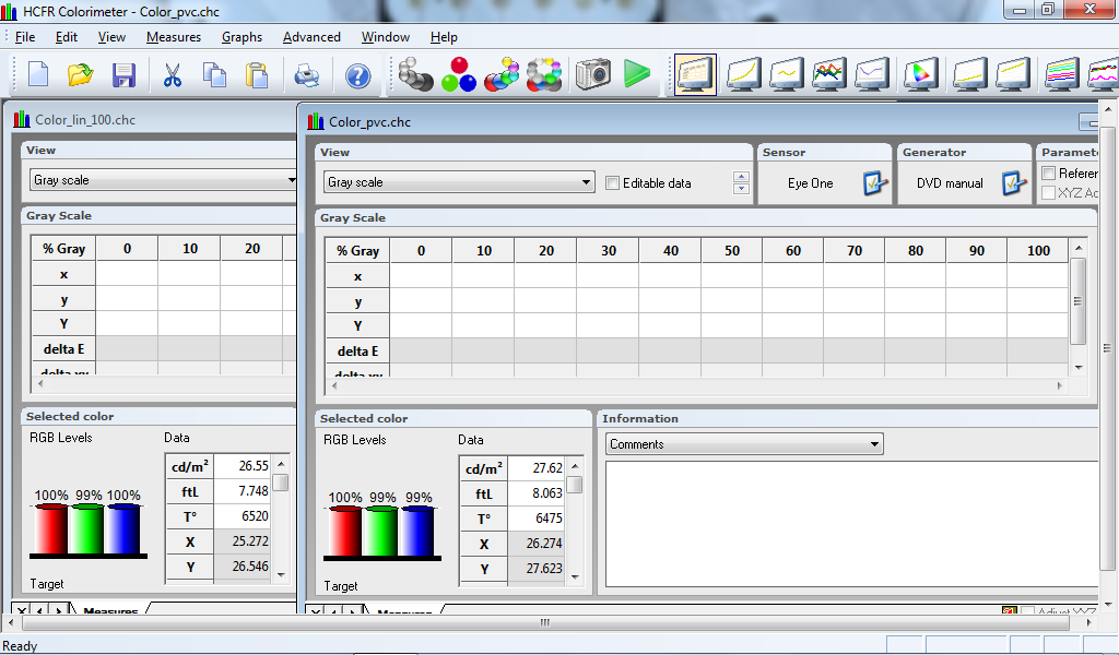

Use a paint with titanium dioxide white. That has the right color temperature. The gain will be close to 1 or even above when the underground is not transparent.
If you go to a art painter supply shop you can get the painters cloth linnen not the caton that has a nice gain as I measured once and the ftl was just a little below gain 1.3 pvc cloth. I use the linnen cloth works very well can be cleaned and is oil resistant. It is very cheap too as painters need a lot of it and are not very rich Wink Think you can glue it to a background.

 Filesize:  103.3 KB
 Viewed:  2590 Time(s)

Yes, it's that easy. ftL off your paint / ftL off gain-1 = gain of your paint.
The gain-1 gesso redfox01 suggests works fine on a flat screen, but don't use it on a torus. You want higher gain in a torus, usually around 3 or so. That higher reflectivity reflects the light in the direction you want so the torus can concentrate the light at your viewing location.
A gain-1 surface doesn't work with a torus. A gain-1 torus won't be any brighter than a gain-1 flat screen. Not only will you lose the focused light that produces the higher gain you're looking for, the gain-1 surface will disperse the light so much that it will strike the adjacent surfaces of the curved screen. You'd lose a lot of ANSI contrast because bright areas of the screen would wash out darker areas of the screen.
