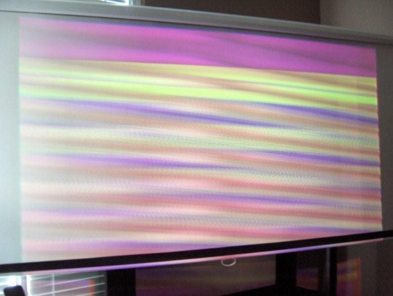

I agree with Analog, either the bluray reverted to 1080p, somethings not plugged in correctly, power to Fury might not be working (one of my fury's doesn't connect well to power supply) or as I said could be a handshake issue. those are a pain in the a$$.
Posted: Sun Sep 14, 2014 2:44 am    Post subject:
If it reverted to 1080p it should show an image on a 9PG, albeit a pretty blured and slured one.
Mr. Green
Joined: 23 Feb 2007
Posts: 1394
Location: Calgary
Posted: Sun Sep 14, 2014 3:13 am    Post subject:
Mine won't, it gives an error message and nothing but wavy lines. Can't remember the error... Vsink out of range or something. This is what 1080P looked like on my 9PG+.

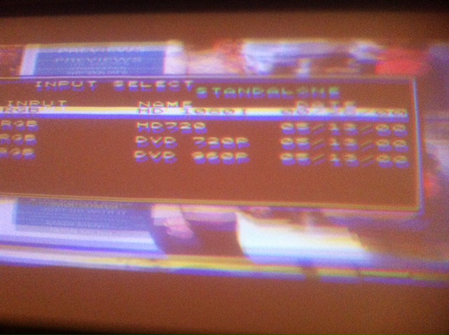

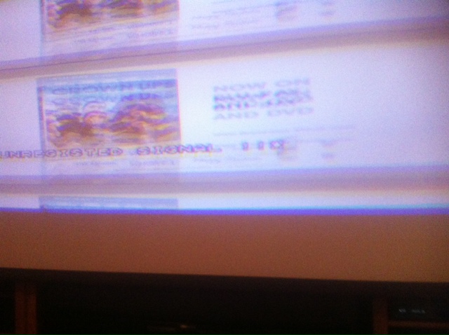

Posted: Sun Sep 14, 2014 3:49 pm    Post subject: NEC 9 PG Pic
Got image back but what is going on now is that when I plug in my BNC connectors to my projector it goes crazy when I put the last one in the yellow vertical one. I tried switching incase it was pluged in wrong and it does the same thing. as so as I disconnect the yellow vertical cable the pj pic comes back. I messed up my pic from trying to make adjustments. this is very frusterating and I appreciate all of your help

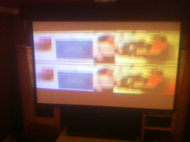

Posted: Sun Sep 14, 2014 5:34 pm    Post subject: NEC PIC 3
Here is my pic of what it is doing. Can someone let me know where the Yellow and White BNC go? Which one is horizontal and which one is vertical?[img][/img]

Posted: Sun Sep 14, 2014 5:46 pm    Post subject:
That looks like a double picture. Is it the same picture top and bottom? One over the other?
Are you sure you have the correct memory location selected in the projector?
