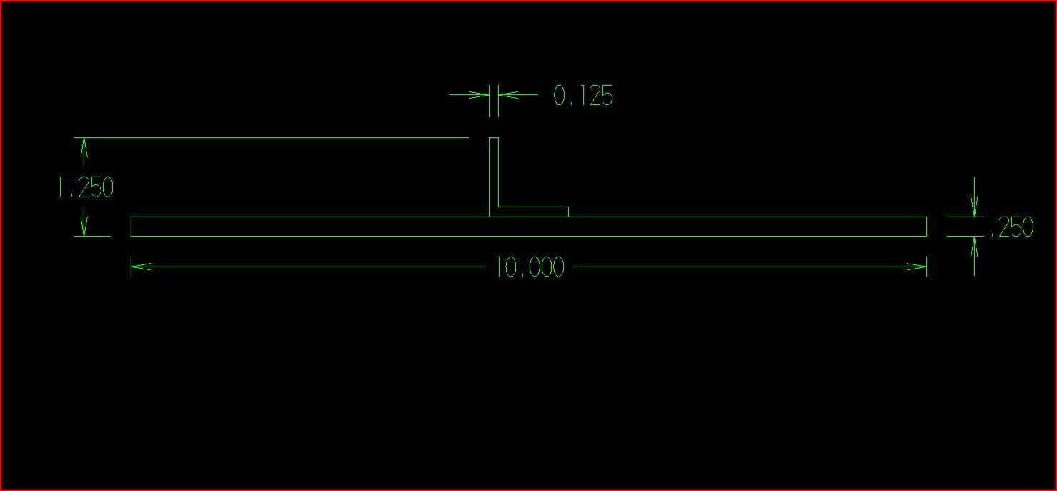

a small piece of angle Aluminum, like 1" x 1" x 1/8 or even 1/16th, is nice because if you screw it down to something it makes the effective thickness of the underlying material a full 1"+ in terms of it's resistance to bowing without adding all that weight or expense of buying a massive piece of material.
in other words screw it down to the backside on your existing mask and straighten it out
