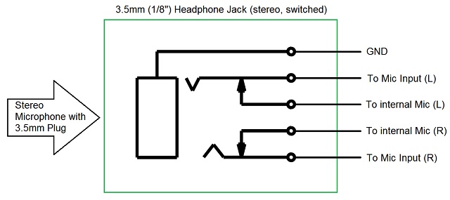

So I'm looking for a high zoom point and shoot that can do video in a pinch. Problem is most dont have a mic jack.
How would I wire in one? I want it to interrupt the internal mics when the external mic is plugged in. Just as it does with a real camcorder.

For this you would be needing a switched 3.5mm (1/8") jack. If the built in Mic is stereo, by cutting the cable going to the Mic, you will have three lines on each side of the cable (Left, Right and Ground). Connect the ground back together and You have 5 lines (Left from the Mic, Right from the Mic, Ground, Right to the PCB and Left to the PCB). Connect these according to the diagram below. Done!
This will only work if You use the same type of Microphone as the one built in (most common: Condenser microphones).

Posted: Fri Sep 05, 2014 8:56 pm    Post subject:
If you're going to record from an external mic, then you should also have an adjustable mic gain and a headphone output so you can monitor what you're recording. Besides the fact that you'll kill the warranty, and that whatever mic recording circuit the camera has may not work well with whatever external mic you pair it with, I think this is probably not a good idea.
