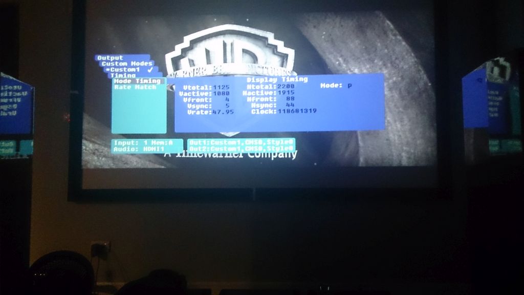

Posted: Wed Aug 27, 2014 3:30 pm    Post subject: Ask help for correct Lumagen XD timing parameters for BG 808
The attached is my working timing of Lumagen XD for my BG 808s, which is almost the same as the factory default 1080p/48hz timing except the horizontal res changed from 1920 to 1915. I don't know why my BG808s can not lock the signal of factory default timing. I tried to adjust each timing to make it work, but only when I decreased the horizontal res one click or more, and then it can lock the signal. The more clicks I decrease, the more stable it is. Is there any suggestion that I can try?
By the way, I would like to set up a 72Hz setting. Maybe like 1440x1080 @72 or other, is there any working timing for this set?
