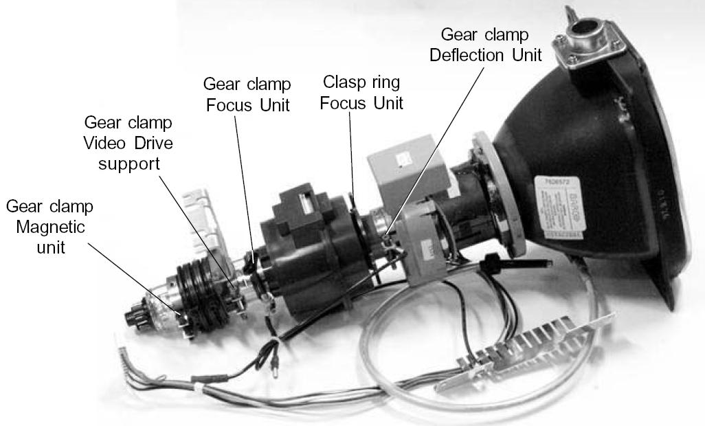

Posted: Thu Aug 28, 2014 7:28 am    Post subject:
Crack seem to bee at focus yoke clamp area.
There is also neck board support clamp, but it's bit further back.
Yoke clamps have grounding cable to neck board. Don't think leaving it unconnected would cause any harm, I guess grounding is just to make yoke adjustment more friendly.
