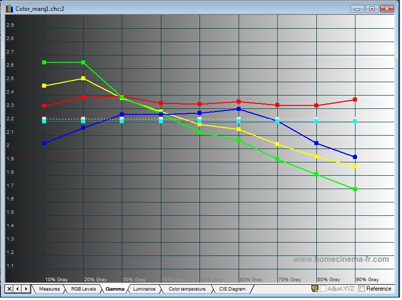

I once had a Marquee with fast phosphor on green and the gamma on green was like yours until I raised the scanning frequency to 72 Hz. Perhaps something to try?
I had to run at 120 Hz to get the same output as 60 Hz on a normal tube. In the end I corrected the gamma with a scaler too and that was a fine solution.
fast green phosphor
 Filesize:  74.61 KB
 Viewed:  7549 Time(s)
Posted: Thu Aug 07, 2014 1:10 pm    Post subject:
Here is a calibration file from a standard Marquee, with no digital correction.
