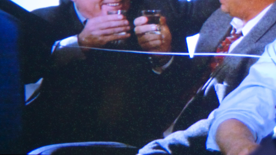

Hi everyone, I want to ask somebody's opinion on this issue I've been starting to have with this Onkyo receiver I bought new on Newegg.com less than a week ago! Already having video issues with it. I've read that this model had HDMI board issues and I think I got one of the bad units. It was working great up until yesterday.
I'll be watching a movie for a half hour or so and all of a sudden this green static appears all over the screen. Looks like an old cable channel that has RF interference. Very annoying. I'll change the input to another source and it goes away. But will eventually come back.
I'm really bummed out because of this because I am really happy with the sound quality and build quality. But is unusable in its current state obviously. Is this an issue I should take up with Onkyo? Maybe they would send me their current model the 838. But unfortunately it does not have Dolby Volume which is one of the main reasons I bought it. Really nice to enjoy a movie without disturbing anybody in the house with earth shattering bass (which I love, but annoying to everybody else here). I don't know how Onkyo treats its customers. Its the first time I had one of their receivers. Why can't they get these HDMI boards right? Is it just that its a new technology, or they're just half assed with testing and manufacturing?

Yep, lots of issues with Onkyos with HDMI boards. I threw out 2 last week. Send it back, and get something else.
Posted: Thu Jul 24, 2014 5:45 pm    Post subject:
Those Onkyos have a heat issue with the DTS chips that have a Ball Array solder connection. The boards heat up and loose solder contact.
I have repaired some Onkyos that do that. I add a heat sink to the DTS chip and main CPU chip as well.
But yours might be an actual HDMI chip problem.
Id send it back and ask for new one.

I hope newegg.com gives me a pre paid return label. I was thinking about a heatsink would be a good idea with those chips, but i'd only do that if i didn't have a warranty. It was kind of warm in here last night though... its fine now, its cooler today. So Maybe i'll try a heat-sink, it wouldn't void the warranty would it?
