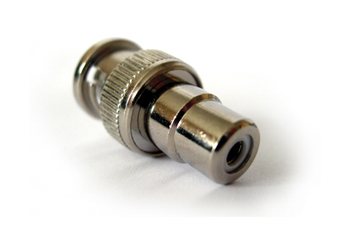

Yeah or try one of these on the composite input:
