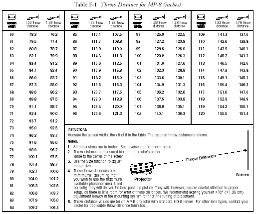

Hey guys, I can't find my old Marquee files. Can someone tell me the approximate distance a ceiling mounted (8' ceiling) Marquee 8500 non-LC would need to be to display an 86" wide 4:3 image when using most of the raster?
Trying to figure out where to place my RGBHV wire bundle for a future, possible Marquee setup for computer use.

Found something good enough.
