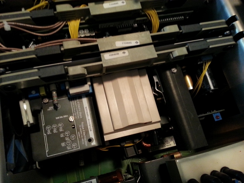

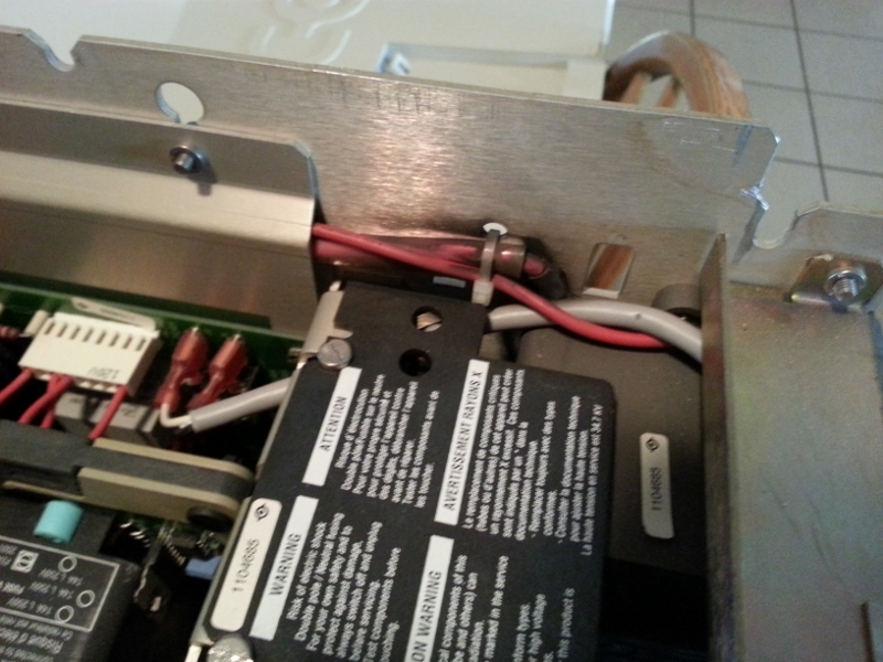

Back to the CRT, I noticed one of the cards doesn't have matching numbers like it was changed I think it's the input voltage and there's a burn mark like something fried. It does turn on and shows the setup I haven't mounted it yet but I'm guessing it's all ready been repaired.[/img]
Posted: Tue Jun 24, 2014 2:46 pm    Post subject:
Try to get a picture up so we can see. If it is the AC input board, it can burn out parts and still work but you loose noise control or safety.

Here's the burn spot on the housing and red hv lead

Here's the mismatched card as everything else have the same number but this card.

Posted: Tue Jun 24, 2014 3:12 pm    Post subject:
That is the high voltage wire going to the splitter. That black soot can be caused by 2 things. 1 is it may be arcing occasionally or 2, the static charge created by the high voltage may be drawing contaminants to that location. You can keep using it but if you hear an arc every now and then, then this would be the first place to look. Or you can remove that zip tie and examine the wire carefully for cracks or splits.

Posted: Tue Jun 24, 2014 4:22 pm    Post subject:
The board number you have in question I believe is the SMPS or low voltage power supply. There use to be a list here somewhere which indicated which HV boards would interchange.
The Tom W. you bought this from, is that the same Tom W that is a member here?
Posted: Tue Jun 24, 2014 4:26 pm    Post subject:
Here is your chart. Check your part numbers and compare.
http://www.curtpalme.com/docs/BarcoServiceBulletin_R762716_New_EHT.pdf
