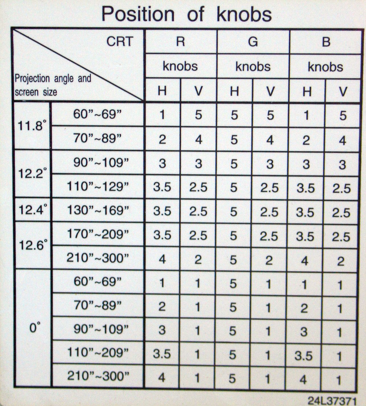

I need a photo of the diagram that will be stuck on the inside of the front cover that goes around the lenses on an XG LC.
It is the sticker that tells you where to set the flapping rings for various screen sizes and projection angles.
The one inside my cover is for HD-144/HD-145 AC lenses, its now LC with HD-18 lenses and i dont know if the diagram is the same for both types.
Thanks Smile

This is what I have:
XG LC lens flapping adjustment table
 Filesize:  346.77 KB
 Viewed:  7932 Time(s)
Posted: Sat Jun 14, 2014 9:48 am    Post subject:
Awesome work Gàbor, exactly what i was after Wink
