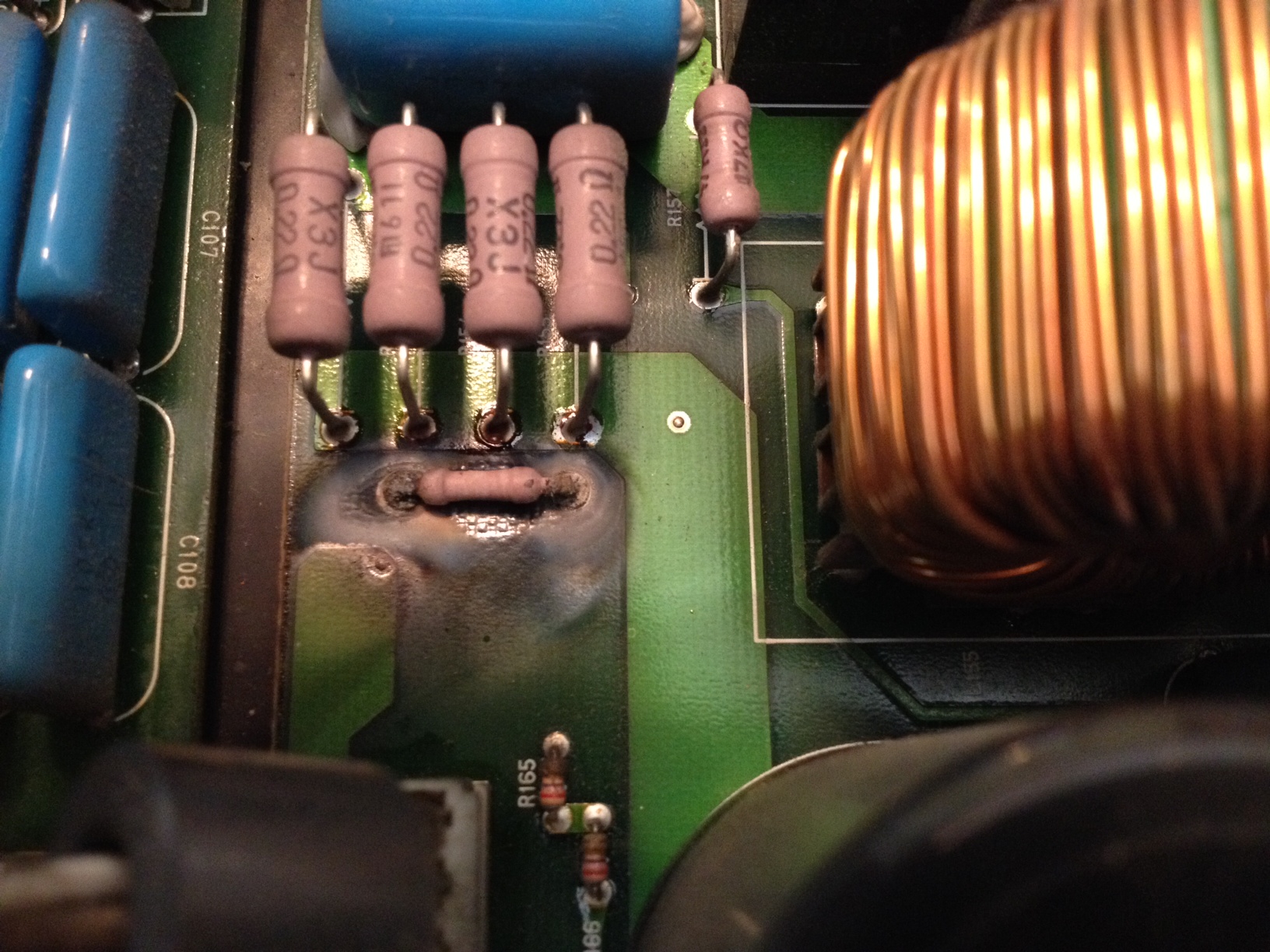

So the fun continues. I was able to pull the LV power supply without to much trouble. I did have to unhook several wire harnesses, but did not need to remove any lenses. I love how modular everything seems to be inside these projectors. Anyway I decided to open up the power supply case and low and behold I found what looks like a little fried resistor on the first board in the line. I took a great picture of it. Do you think this is the problem? Does it mean I have bigger problems somewhere else? Thanks all for the help. It is kind of fund trouble shooting.

Posted: Sun Jun 08, 2014 11:50 pm    Post subject:
you most likely have other issues. Resistors never overheat without there being another problem somewhere. Still, I'll bet it's isolated to a problem within the power supply.
