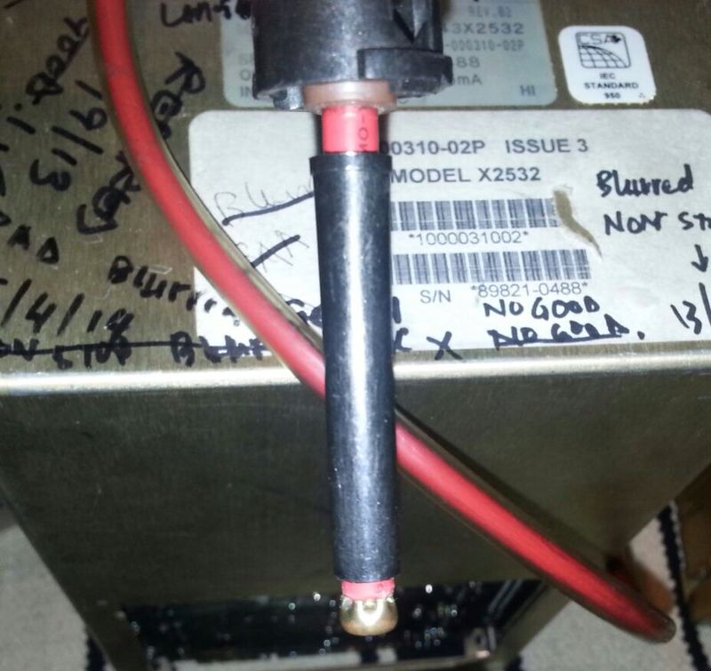

Lately, Barclay helped me to troubleshoot several HVPS for me and one of my HVPS exhibit black horizontal lines after repaired.
What happened was after cleaning the connector tip of the HVPS, the black sleeve got stuck to the metal tip and the contact to the splitter wasn't that good and it caused very bad horizontal lines. Therefore, i removed the HVPS cable out and loosen the black sleeve to ensure that it's loose.
I then re-installed the HVPS cable again to the HVPS splitter and the problem goes away till now without any issues. However, I'm not sure whether it might resolve your issue but i think it worth a try.
HVPS black sleeve got stucked with metal tip during cleaning with alcohol cleaner

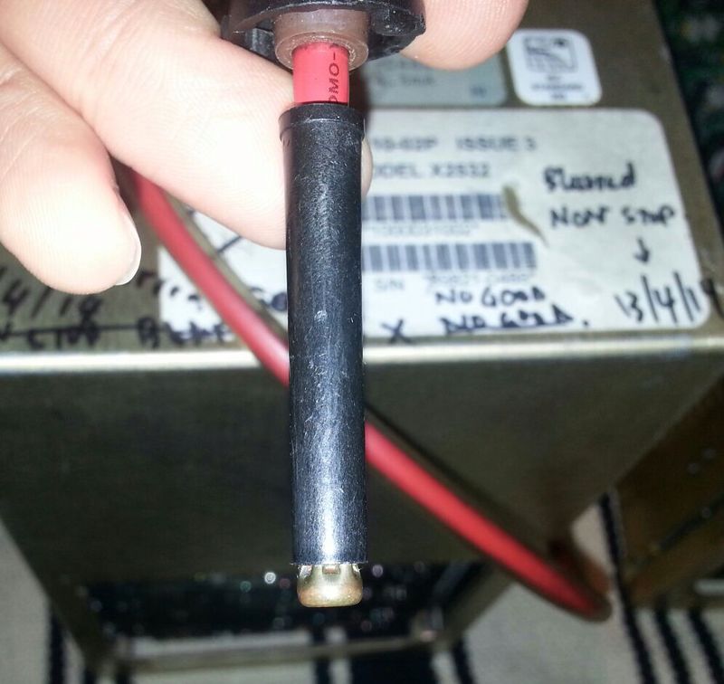

Just hope that this method will help to resolve your horizontal lines issue.
Disconnect and loosen the black sleeve from metal tip, re-install and horizontal black lines goes away. Hopefully, your issue is the same as mine.
