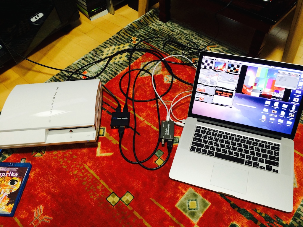

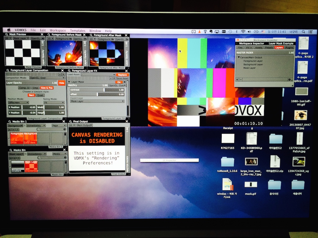

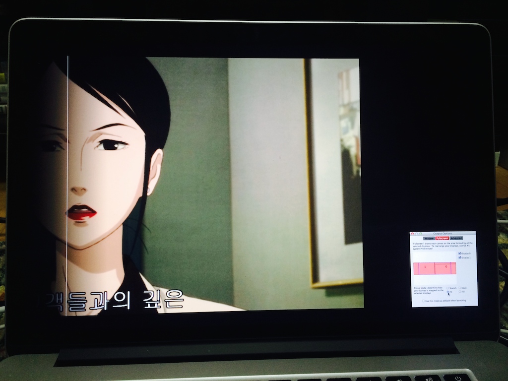

Hi everyone.
Please call me 'soleboy'
I am a long time member of the forum, but did not do activities.
I had used CRT projector 10 years+
Meanwhile I wanted to do 'edge blend' so so bad
But hardware way is way too expensive for me.
(I have tvone c2-7100 but there are input output limits)
So search and found another way.

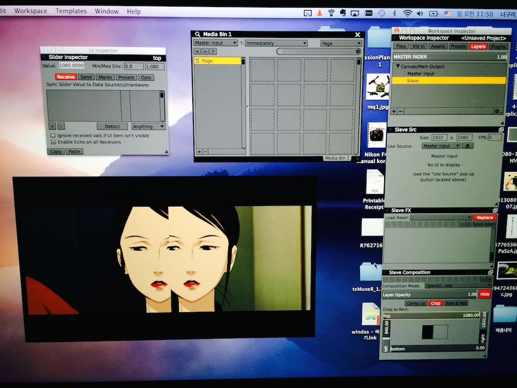

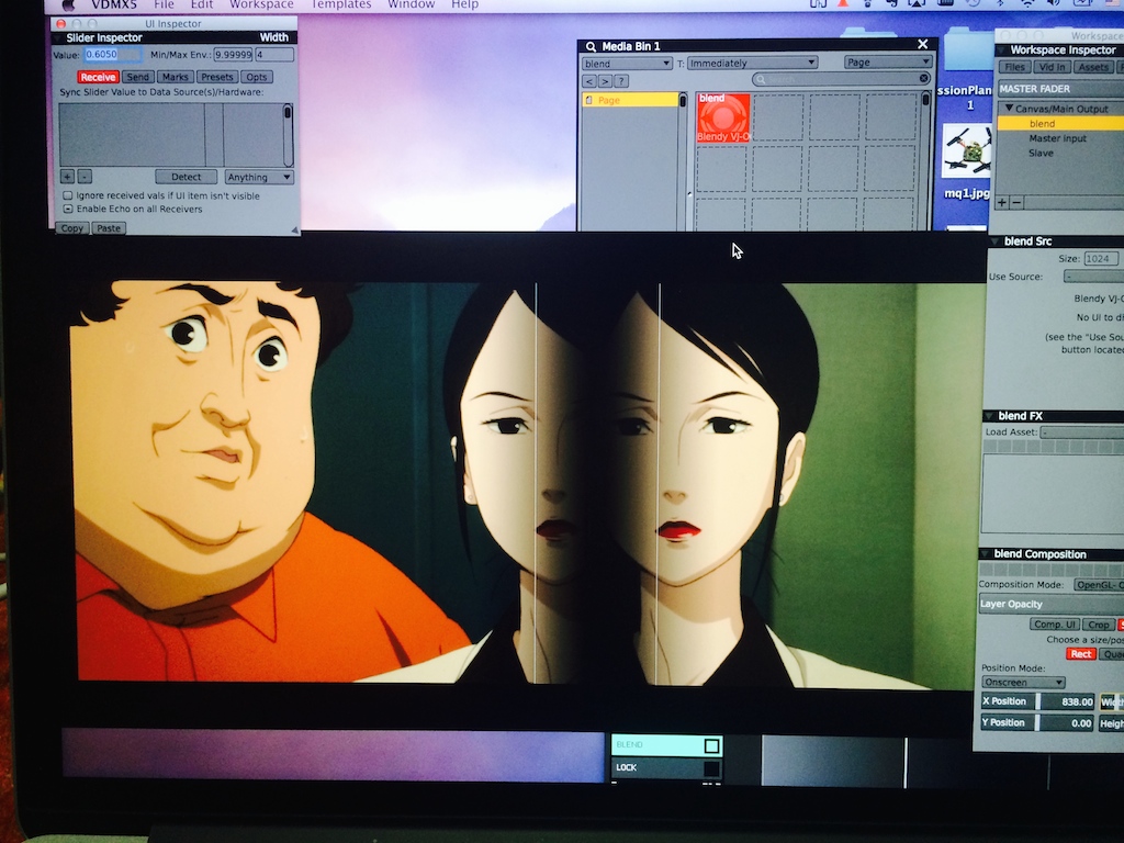

todays world wide VJs are using VJing program based on 'syphon.
http://syphon.v002.info
--Syphon is an open source Mac OS X technology that allows applications to share frames - full frame rate video or stills - with one another in realtime. Now you can leverage the expressive power of a plethora of tools to mix, mash, edit, sample, texture-map, synthesize, and present your imagery using the best tool for each part of the job. Syphon gives you flexibility to break out of single-app solutions and mix creative applications to suit your needs.--
http://vidvox.net
VDMX is syphon based video processing app for vj
The input and output video and images can be edited freely.

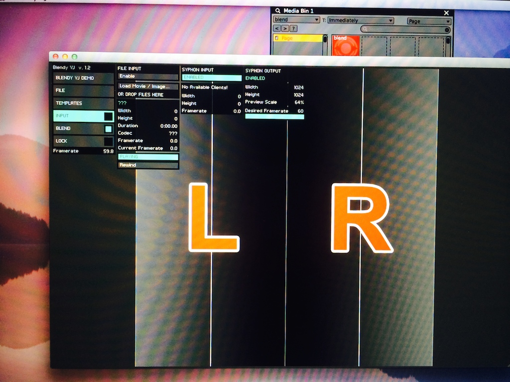

http://www.blendyvj.com
blendy vj is syphon based app for alpha mask blend zone

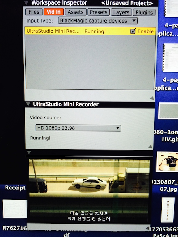

Hardware setup::
PS3 - HDMI Splliter - Blackmagic HDMI capturecard - macbook pro retina 15 - HDMI to VGA - cine9 (Thunderbolt to VGA -second cine9)
Software setup::
VDMX5 - Blendy VJ - Switch ResX
I did not complete my setup. one PJ is in my house. another PJ is in my office.
Any question is welcome.
Thnakyou.
