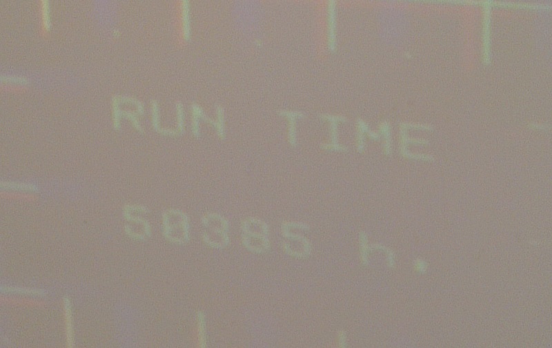

RP's seem to have a lot of hours on them. Don't know if my tubes are original (hope not) but I was a bit surprised to see this.
That is almost 6 years, 24/7. I think they all came from some sort of controlroom. I'm curious to find out about the others.

Well I guess I'll start leaving mine on 24/7 to catch up! Smile
Mine are definitely the original tubes. I run both contrast and brightness well under 50, and tube emission is perfect. I pulled out the tubes in January, only the green has the slightest of 4:3 wear.
