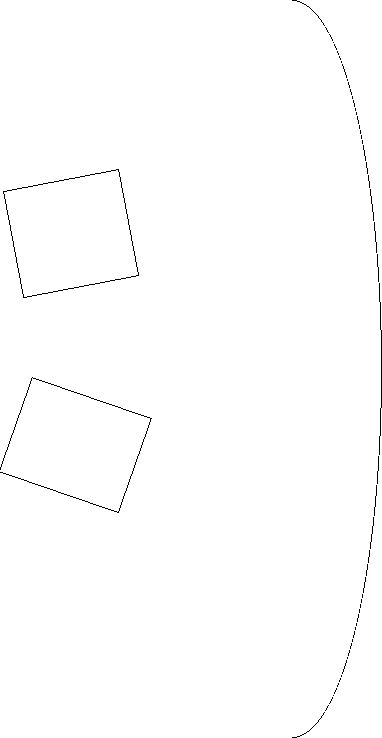

One thing to remember: the middle picture, with the flat screen, won't have reflective properties like that. With flat screens you use low-gain surfaces, ideally 1.0 or even lower. You can go as high as 1.3 but you'll have some hot-spotting. (I have a 1.3 screen and there is noticeable hotspotting.)
Low-gain surfaces scatter light pretty uniformly. So the mirror-reflective lines you drew don't really reflect reality. (see what I did there Smile) With a 1.0-gain screen you should have almost uniform light scatter, regardless of the angle of incidence.
Posted: Mon May 26, 2014 7:09 pm    Post subject:
Projectors should be perpendicular to center of the 4x3 section of screen like this.

Posted: Mon May 26, 2014 8:19 pm    Post subject:
Yes Gary, you are sure right about the 1 gain screen and uniform reflecting.
But i wanted to compare flat and curved (or torus, but from the upper view, it is the same).
I didn't really care about the gain or its effect while drawing this. It is just meant to understand how light is reflected by a torus vs. a flat "mirror".

I like the idea, Athanasios draw. So every projector has its own torus. Apparently.
Should not be a problem for the lenses and scheimflug wouldn't be stretched too much
(like if 2 projectors were parallel to each other).
