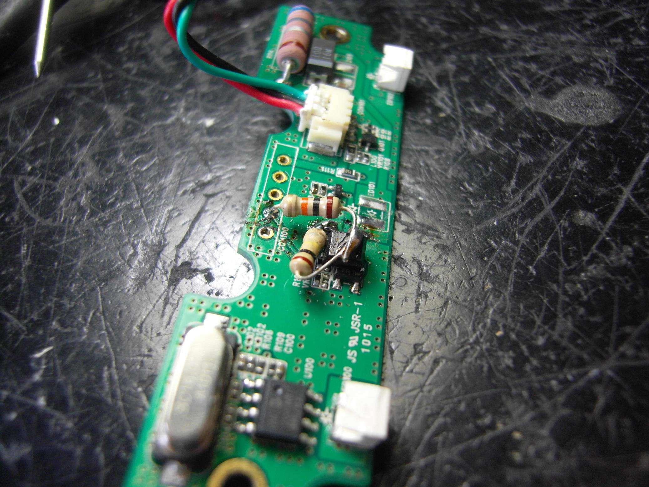

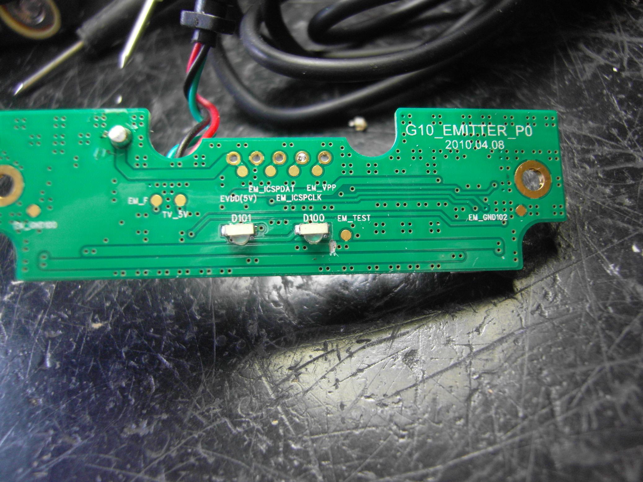

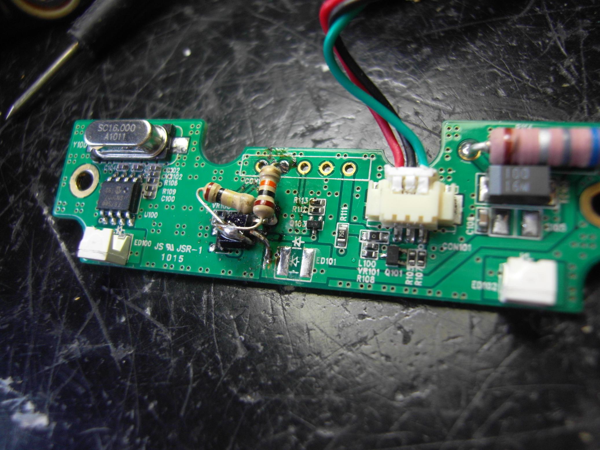

Launch tube unchanged with SILICON BIAS RESISTOR TRANSISTOR A114 100K 10K resistors, infrared left. The right of the infrared emission control signal is reversed

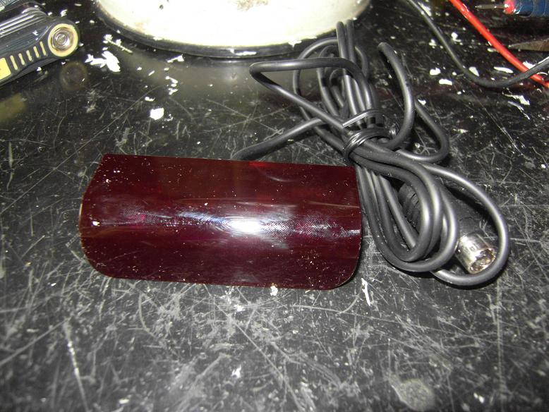

Find an obstruction blocking the use of infrared emission around about one launch tube must be shielded 3D glasses will not work otherwise,

Posted: Wed May 07, 2014 5:37 am    Post subject:
Is that for the 3D emitter?
zxh398
Joined: 05 Nov 2009
Posts: 55
Location: china guangzhou
Posted: Thu May 08, 2014 12:12 am    Post subject:
Yes, you can modify this transmitter has a left and right eye so 3DFURY conversion function
