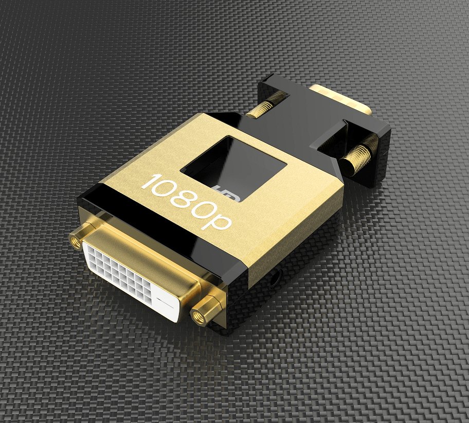

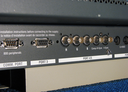

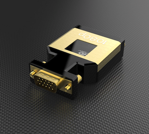

Hello,
Just purchased a Barco Graphics 808 for 70 Euro, quite happy with it...
Now I want connect to the Port 3 a HDMI input, using a convertor from HD Fury.
However, just noticed that the convertor has DVI-D at one end (which I can convert easily to HDMI with a short cable) and VGA D15 at the other end while I expected there D9 since the Barco uses only a 9-pins VGA.
How can I fix this? Should I solder myself or are there prefab solutions (D15->D19)...Is soldering tricky in order to get could results?
Any advice/pointers?
Thanks!
-brt (located in the Netherlands)...

If you already have the HD fury, you need a HD15-5*BNC (common) or HD15-DSUB9 (rare) adapter.
If you don't have the HD fury yet, I have both a HD fury with adapters and the DVI -> port 3 adapter (https://www.curtpalme.com/forum_archived/viewtopic.php@t=28794.html) laying around. Drop a PM if interested.

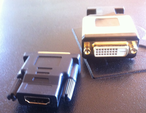

I have the Fury already so I need the HD15-DSUB9 adpater then, I guess...Do you have one of this for sale?
Otherwise, I should solder from VGA 15pins-> 9pins as I understood from this:
http://www.curtpalme.com/Barco_Port3_Input.shtm
I got already the DVI-D->HDMI adapter, so that's ok (see attachment)...
