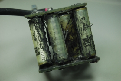

ok,actually the quadrupler is repaired by my friend, as you know, the quadrupler is big problem for barco projector, it really pulzzed us during past years until mid summer of 2013.

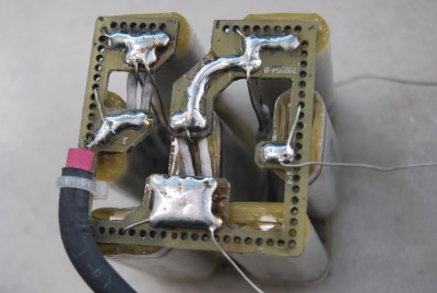

My friend detached quadrupler and did anasylsis of its structure and damage cause, he found out barco quadrupler is 7 multivoltage, there are 7 multvoltage capacitors in quadrupler, 6 are double-voltage except the first one, output voltage is 34700V, divide 7 and multiple 2, each capacitor bear 9914.2V,but real situation is actual voltage is a little bit higher,the front will bear more higher voltage than rear ones, that is why front capacitor always broke first.
if the first broke, then the rest will share the tatol voltage, the rest capacitors break one by one as time lapse,that is cause barco quadrupler is prone to be damaged,maybe there is a explanation,to damage the quadrupler for protecting electron gun if problem happened,anyway, quadrupler of barco is weak parts.
Now it can be fixed, you should find high bearing multi-voltage capacitors(recommened 20000V bearing capacity),and arrange that in to original case, remember making sure no more than 5000V between two capacitor to meet demand of isolation of 704 silicone grease.
after finish this job. you will get best quadrupler to enjoy your HT, never warry about your quadrupler.

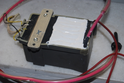

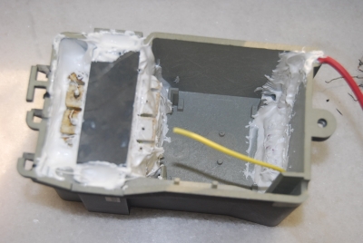

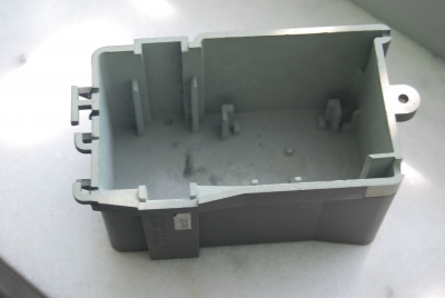

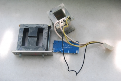

here are some pictuers may help.

To maunfacture new one is hard cause it is very difficult to find good high-voltage transfomes(1:15),self-made is not reconmended,silicon irons and transfomre is not proned to be damaged like multi-voltage capacitors,so we just use original case,transfomer and silicon irons, only capa need to be replaced.
new replaced capa with high bearing ability, it is very hard to break, good quadrupler make best focus and brightness even watch 3D movie it can output stable high voltage to eletron gun.

Wow man this is awesome! Do I understand correct that this quadrupler is filled with the white silicon kit? They used to use oil bads with high voltages. Very important to keep the unit from sparking into the air.

the white one is silicon grease to isolate high voltage enclosed from leaking.
barco original quadrupler is not good cause inside multi-voltage capas bearing 10000V which almost equal to its maximum bearing limit when thay are working , it is not strange if it is damaged.
If you use bigger bearing ability capas such as 20000V, the volume of capas are bigger accordingly,so it is very important to arrange these capas in original frame .
To use 704 silicon grease fill and cover, remember do not use too much one time since it will never dry if it is too thick.
