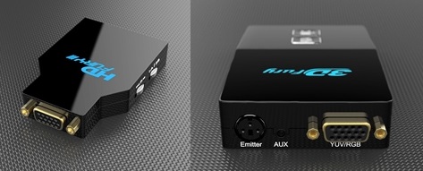

The HDMI board is 100% sure a HD Fury 3
barclay66
Joined: 27 Jun 2011
Posts: 1304
Posted: Sat Apr 05, 2014 1:05 pm    Post subject:
I agree. The PCB of the 3D Fury has a different layout with the analog output at one side as opposed to the centered output at the HDFury 3.
A solution using a Moome board instead will most likely have a bandwith advantage as severeal tests between Moome boxes and cards vs the HDFury have shown this. Nash was able to show oscilloscope measurements on this in another thread.
Of course the integration of a 3rd party board to a Barco input board requires a great amount of care in order to preserve the 3rd party's board quality. What I want to say with this: You could have the best possible HDMI converter circuit in the world but still woudn't get great results if the adaption to the Barco's input circuitry was sloppy...

Posted: Sat Apr 05, 2014 2:17 pm    Post subject:
Regards,
barclay66
Ahem, and let me clear my through.
Those photos Nash (Tom) posted were my photos using my Tektronics 465B analog scope. Nash didn't cite my work or that I took the photos. I pointed that out in the last thread I saw him using my photos without citation. I should have put my logo on the photos. I have scope photos of almost every (maybe every) DVI and HDMI transcoder running 1080i 60, 1080p 60, and 1080p 72; both internal and external versions.

However, the thing about the Moome boxes is that on the v2 there are two sub-versions. One can resolve 1080p 60Hz with only about 5% attenuation and the other has about 70% attenuation. Obviously depending on which one you happen to have will result in a tremendous difference in the 1:1 pattern.
If you have a scope you can run 1080p 60Hz from the Moome EXT to the scope and look at a 1:1 pattern. If it is nearly fully resolved than it's the good one. If you have the bad one, you can change the filter caps and then it is fixed to full resolution.
craigr

The Moome v3 has excellent bandwidth with less than 5% attenuation at 1080p 60Hz. That would be a good test.
The HDFury 3 has many issues. One of them is that the analog output circuit is kind of crummy. They had some issues with it and so they added peaking in the software that controls the DAC. In the end, what they did was make it so that the SMTPE 1:1 would look perfect at 1080p, but at lower or higher resolutions it's not so good.
The problem with this is that in real world performance test patterns with 1080p 60Hz look nearly perfect, but in the real world there are going to be frequencies required that don't fall in line with the full bandwidth of the signal. I don't know what this means for real world images in reality, but there is quite a bit of artificial "enhancements" used on the HDMI chip.
craigr
