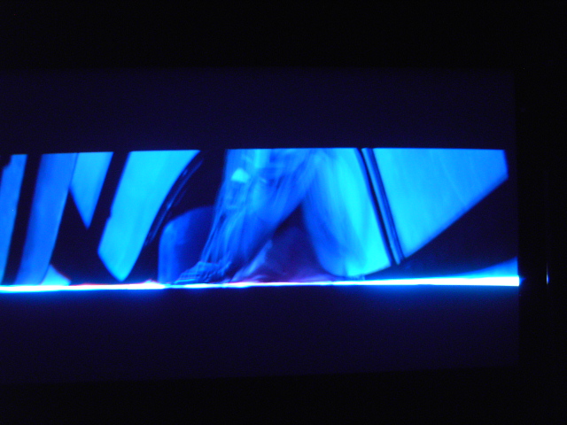

Hi guys, I have been busy watching movies lots and lots of movies and was happily doing this until my 4600 suddenly gave problems.
I put the PJ on and the picture has been totally compressed into about 40% of its height, I now have superwidescreen and a picture that I cannot watch. It looks about just over 60 cm in total height from top to bottom. The width, thankfully, is the same.
Any advice would be appreciated.
The picture should cover almost the entire black area.

Posted: Sun Mar 09, 2014 6:25 pm    Post subject:
First, don't use the machine this way, you risk a deflection line burn in your tubes.
You have a vertical deflection (board) problem.

Posted: Sun Mar 09, 2014 6:33 pm    Post subject: whew
THANKS!
I was not intending to use it but I thought I better take a picture as soon as I could at least.

Posted: Tue Mar 25, 2014 1:10 am    Post subject: cool
Hi guys,
Got the board from Curt, thanks for all the advice, the pj is now perfect. I had quite a lot of drift for a while just thought the pj was getting old. However, the image is now totally stable, for anyone's else's future information my board caused specific problems like convergence drift.
Thanks you all for helping save my pj and allowing me to enjoy it longer, thanks for the extra board Curt much appreciated.
