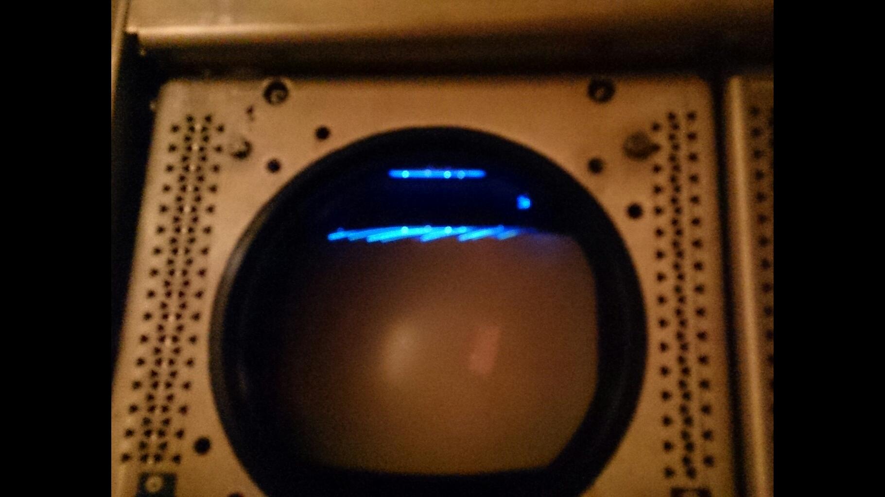

Thought I better start a new thread for this since it's a completely new and separate problem from the other.
After pulling the tubes for new silicone and housings but no electrical changes what so ever, I got some very strange scan problems. Started with just the blue tube while the red and green showed the line pattern and logo at start-up. Opened it again and checked all connections and tried again and now I have the same problem on all three tubes. If its any help, it stoped responding to the remote control as well when it happened.
Due to dark conditions and crappy cell phone camera, the shutter time is too long for the pattern to show clearly but it looks like a saw-tooth line with low amplitute at the very top of the tube face, partially outside the phosphor area. I took a video of it which I will try to extract something useful out of tomorrow.
Any ideas?
[img]http://www.curtpalme.com/forum/download.php?id=17914[/img]
 Filesize:  138.15 KB
 Viewed:  6602 Time(s)
Melifluonze wrote:
Posted: Thu Feb 13, 2014 11:28 pm    Post subject:
That's the AKB line (auto brightness). Completely normal on all Barcos.
Press the recessed key on both the remote and keyboard (separately), then press 0,0,0. that will reset the projector and remote to address 0, and it shoudl work again.

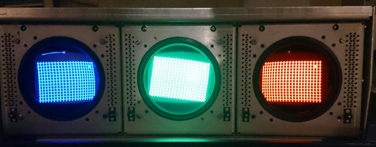

Posted: Fri Feb 14, 2014 8:45 am    Post subject:
Much better! Thanks a lot!
The fringe scan line is still present though... Just mask it out?
 Filesize:  78.14 KB
 Viewed:  7188 Time(s)
Melifluonze wrote:
Posted: Fri Feb 14, 2014 9:10 am    Post subject:
Your deflection coils need rotating.

Posted: Fri Feb 14, 2014 2:39 pm    Post subject:
Decibel is right. Normally that line is over the edge of the tube face. With your raster shift being too low, you can see it.
Go into the service menu and do a 'set to midposition'. That will clear out the memory location. Also, at this point you need to send a signal to the projector once you start setting the projector up.
Posted: Fri Feb 14, 2014 9:07 pm    Post subject:
You need to do a complete setup. After clearing the memory blocks use the cross hair pattern to centre the image and if vertical alignment isn't there use the trim pots on the vertical board to adjust the height of the red and/or blue.

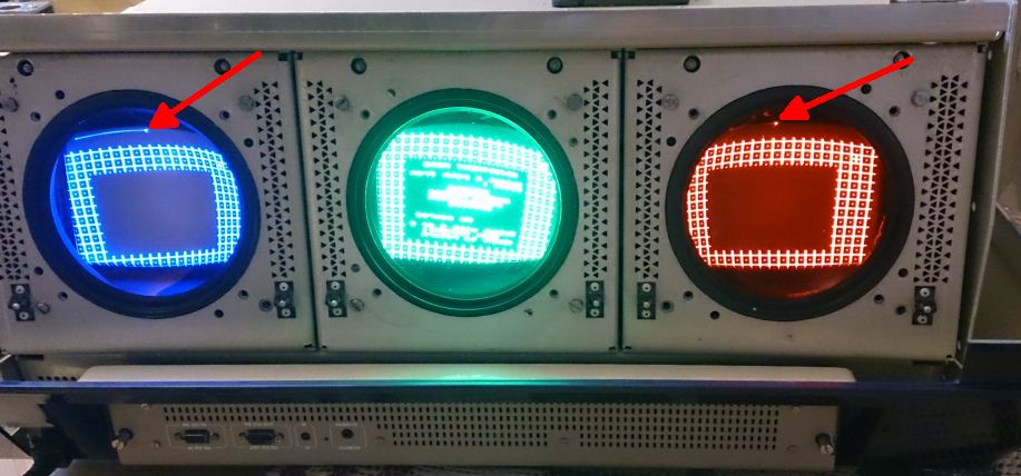

Posted: Fri Feb 14, 2014 9:29 pm    Post subject:
Set to mid position.
I'm still waiting for the setup guide DVD which I hope will bring some valuable insight for how to do the setup. Hopefully it will arrive next week, otherwise I will do a preliminary setup to evaluate the throw distance and blue wear.
Ah yes, this part has got the best of me several times while attempting to set up the 808. Do the setup with the built in pattern becase it's fast and easy, connect the HTPC, start all over, genlock to the HTPC and do the setup again, test with video only to realize I need to adjust phase/porch to get the image centered, realize that the convergence is screwed up again, start over and so on.
Another thing. The green tube is about ten times brighter than red and blue. I know that the human eye have almost ten times the sensitivity to green than red and blue and it will also depend on the white point setting but the 808 have more uniform brightness from all tubes. Is it just a G2 setting?
 Filesize:  89.09 KB
 Viewed:  7129 Time(s)
Melifluonze wrote:
Posted: Sat Feb 15, 2014 12:53 pm    Post subject:
You know, if you wipe out every memory block, connect your source, wait for sync, converge, and the exit, that will become the default setting for any new source.
You can also copy settings from an inactive memory to the currently active one.
Another thing you can do is use the internal pattern to converge any source, if you so desire. It may not result in perfect convergence with the source though, so youre better off using a test pattern from the PC if the internal patterns leave you short of perfection.
Posted: Sat Feb 15, 2014 12:55 pm    Post subject:
Why is your green still tilted? Sort that out before you get any older.

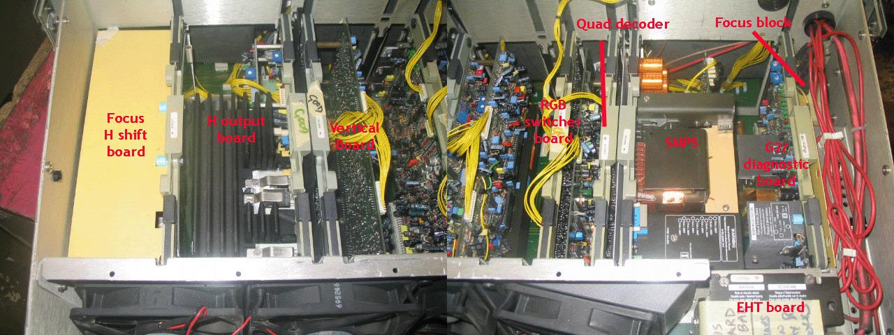

Ok, rotated the coils yesterday so now they sit straight.
There are a lot of things which needs immediate adjustment - G2 on green needs to be lowered and vertical offset on blue and red both needs to go higher to match up with green.
Could someone helpful add some arrows to show which pot does what in this picture?
 Filesize:  128.27 KB
 Viewed:  7040 Time(s)
Melifluonze wrote:
Decibel
Joined: 31 May 2007
Posts: 904
Location: Roma - Italia
Posted: Tue Feb 18, 2014 12:48 pm    Post subject:
- H shift board
There are two (very) little trimmers that shift blu and red rasters horizontally.
-Vertical board
There are two (very) little trimmers that shift blu and red rasters vertically.
There are also two (plastic white) trimmers that expands (or tightens) blu and red rasters vertically.
- SMPS board
There's a trimmer (plastic white, not sealed) in daughter board that expands (or tightens) the raster of ALL TUBES horizontally.
Domenico (Barco fan!)
