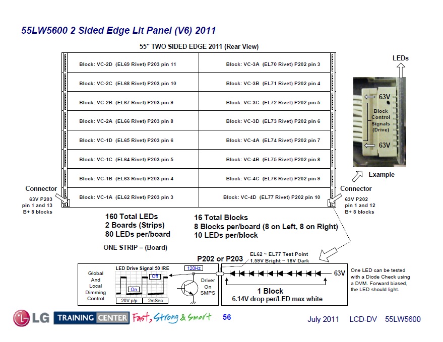

Also, what was interesting is that even though it's an LED TV, the wires between the panel and the light power source seem awfully thick and HV. I haven't done any reading on the newish LED light sources, but do they run on high voltage like the old fluorescent lights did?
Posted: Sun Feb 02, 2014 12:55 am    Post subject:
Well I have not had an LED for repair yet but from what other techs have said the led driver outputs anywhere from 200 to 600 volts. But it's DC. So it has some kick. CCFL is usually AC but at much higher voltage and less current.
I am really trying to avoid flat panel repair anymore. They are so cheap it is almost not worth the time unless it was free. Like you, a quick check of the PS and maybe a glance around and probe a few voltages and then that's it.
Posted: Sun Feb 02, 2014 1:57 am    Post subject:
I guess it depends on how many LEDs are to be driven. This is an edge lit tv so not a lot of LED's and is pretty self explanatory. 63v based on block size. I would guess the larger the block size the higher the voltage. Then current is calculated.

Mac is on the money as usual - the backlights in these LED sets are just like the LED christmas lights; dozens of the damn things in series - xmas light led strings seeing 120 volts AC half wave rectified so they are turning on/off at 60 cycles. I am looking forward to when i scrounge my first dead LED set to open it up and see how its constructed. As for your set Curt I bet there was some wiring/build fault or wave solder blob that worked at first then raised its ugly head after a few hundred hours were on it... like a time bomb ...as a short in the backlight or its driver; when it started up the short caused an OVP or OCP to shut the PS down.... and when it fell over the jarring caused the short to be cleared ?!
