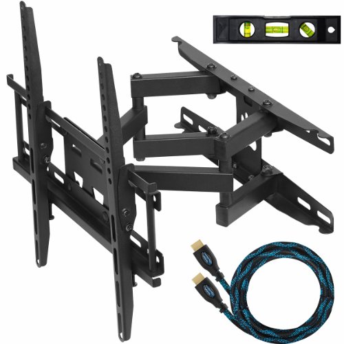

This might be a shot in the dark, but would it be possible to put the thing on TWO articulating arms, one on each side of the back of the set ? It would move a little strangely but might resolve the weight problem.
Here's a sample just think of doing this with TWO cheap regular arms instead of this expensive dual armed mount.

Posted: Mon Dec 23, 2013 5:15 pm    Post subject:
You'd have to do some measurements, but the problem that seems to jump out out at me is that one mount would have to extend well beyond the midpoint to turn the TV out a full 90-degreees from the wall, and the two could potentially interfere with one another.
It's really the 90-degrees that's the problem, when combined with the large extension due to the size of the set.
Did you ever try calling a dealer or two to see if they knew of anything?
