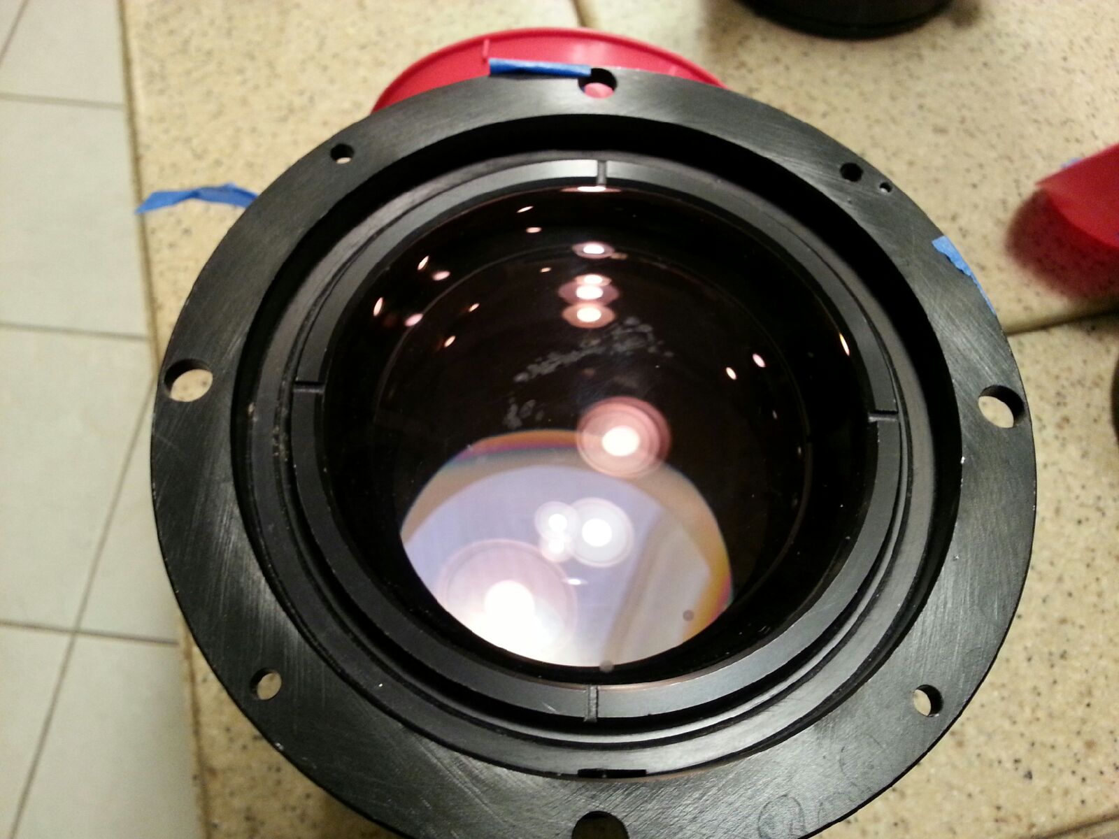

Posted: Wed Dec 11, 2013 12:27 am    Post subject:
Going to try it out...
The worst one... doesn't "wipe off"...

Posted: Wed Dec 11, 2013 3:51 am    Post subject:
I have had the coating removed on the front side of the lens and it wasn't to bad. If you don't like it, then you could see about getting them recoated. That may be more trouble than they are worth unfortunately.

Posted: Sat Dec 14, 2013 5:23 am    Post subject:
I doubt if you would see anything.
I had lenses with the coating on the screen side of the lenses missing in quite a few places, it could not be seen in the image.
