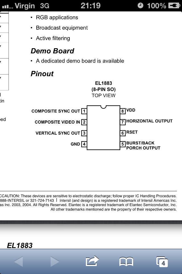

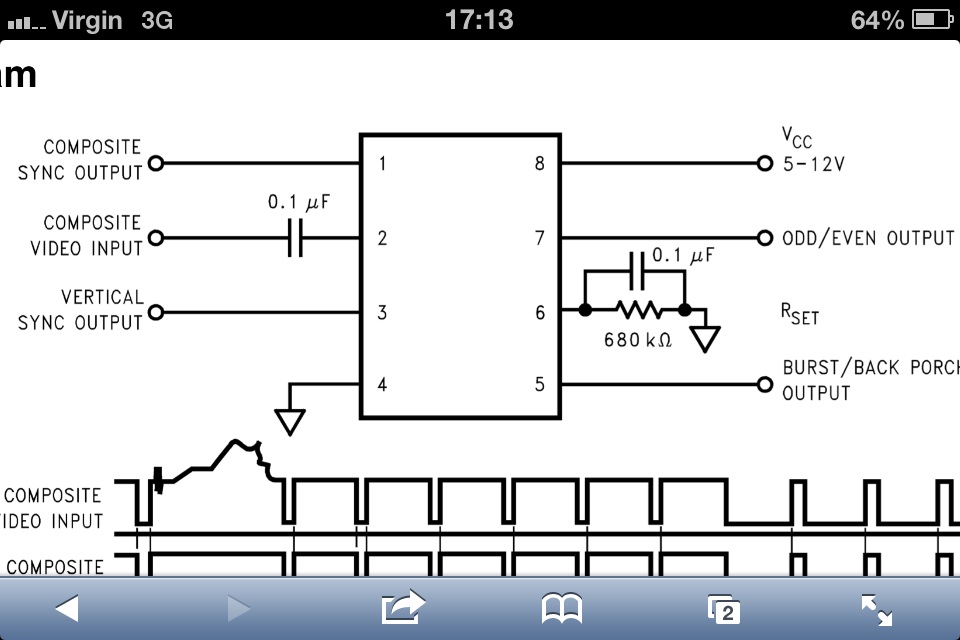

The Playstation RGB has no sync line, it uses composite video for its sync, which doesnt work with any NEC ive ever tried, you can make a simple circuit using an LM1881 and thatll do it. Ive got the diagram at home, but its very easy to find online.

Never mind searching, ive got two here allready for you, youre looking at a couple bucks for everything you will require. Its so cheap its not even funny.
