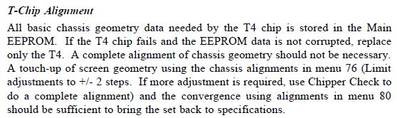

barclay66
Joined: 27 Jun 2011
Posts: 1304
Posted: Tue Nov 05, 2013 7:52 am    Post subject:
Page 150:
 Filesize:  41.8 KB
 Viewed:  31 Time(s)
ptkctc
Joined: 01 Nov 2013
Posts: 44
Posted: Tue Nov 05, 2013 7:59 am    Post subject:
barclay66 wrote:
Page 150:
Awesome! I have my answer now, these chassis's must be unlike other brands approach to ptv, as i had guy on another forum tell me that "they are a different animal, with the separate digicon, separate psb for it, and etc. I didnt get it then, but he was referring to how the thomson ptk195 sets piggyback off a direct view tvs mainboard.
Thank you barclay66, I will consider this a solved issue for now. I will return once I can confirm through hands-on experience that this is indeed the fix.
