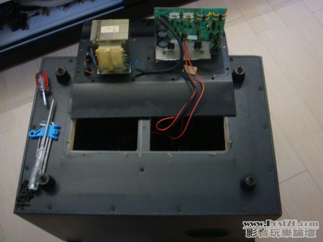

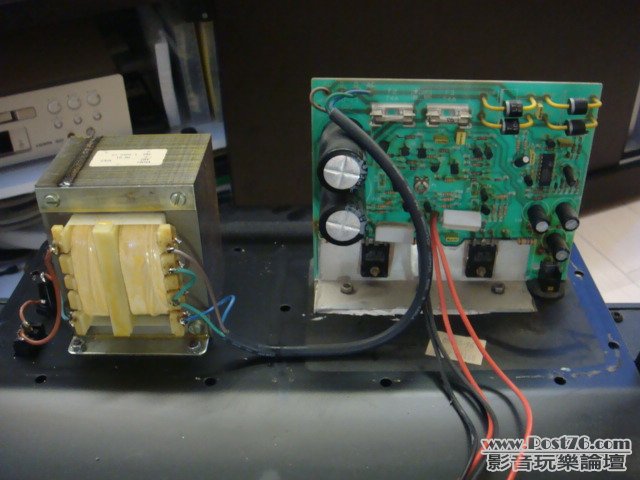

I plug it in, and turn it on, give it a source, and it does not blow a fuse. I can hear sound, but only if I get very close to the speaker - it's very faint. So I took an external amp and hooked it up to the sub: it works.
So the amplifying circuit is obviously not working; am I still looking at a blown power output chip? I did find a schematic finally, I've put it in attachment. Looking at the board, I found a TL084CN; is this the chip in question? There are no other components that look visibly defective or burned out. There is a voltage drop across the caps also.

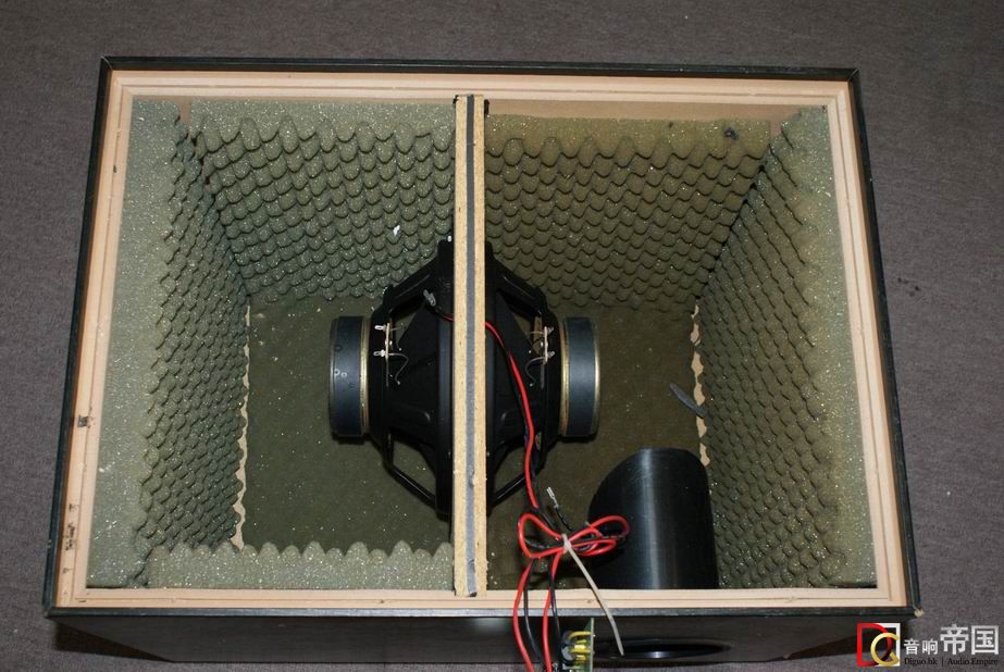

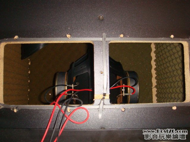

Sure, I could run it off an external amp, but I'd like it to keep the original amp, and I'm interested in learning in the process. Any other hints are greatly appreciated! I found some pics of the sub, not taken by me, but identical to mine.

Offhand, I'd say an open capacitor in the signal chain. This is where a scope would help.
Posted: Wed Oct 08, 2014 7:41 pm    Post subject:
As with any device not working properly the first thing you would want to check are your source voltages. Test them and see what you have.
